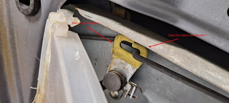

Ohjai Posted November 24, 2023 Share Posted November 24, 2023 The drivers door lock does not always fully unlock when put into park. Most of the time it will work if I unlock it manually, but it does not always fully unlock. I have the door card removed and pictures showing the mechanisms. My first question is is there a replacement bushing available, if so where? Second question, do I need to adjust the yellow actuator? Link to comment Share on other sites More sharing options...

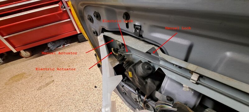

Ohjai Posted November 25, 2023 Topic Author Share Posted November 25, 2023 Well the job is complete, almost. I have a piece of trim to fix. The yellow lever in the last two pictures is fine, no need to alter it. The problem was two fold. The lock mechanism was gummed up. Cleaned it by spraying Kroil or something lime it, into the mechanism and kept activating it until it operated easily and fully. Then did a search on the web for the actuator. The Buick part number is 22020256 (Actuator). Found them from $16.00 up to $80.00. Auto Zone had two of them so I bought both of them this morning. Put one in the left door and everything works as it should. If you reference the second picture the grommet has a slot in it. The new one is a circular hole. 3 Link to comment Share on other sites More sharing options...

DAVES89 Posted November 26, 2023 Share Posted November 26, 2023 Sorry I am late to the game. In picture 2 if you put a real small diameter piece of hose on the the metal part that goes into that rubber boot you will have no more problems. The actuator never goes bad, that slit in the grommet just gets too big. 3 Link to comment Share on other sites More sharing options...
Ohjai Posted November 27, 2023 Topic Author Share Posted November 27, 2023 Dave that is so simple, I am kicking myself for being so one sided. All I saw was the elongated grommet, and how to replace it, not the simple solution you have. Anyway it is now stored here for all those in the future that use the search function of this forum. Link to comment Share on other sites More sharing options...
