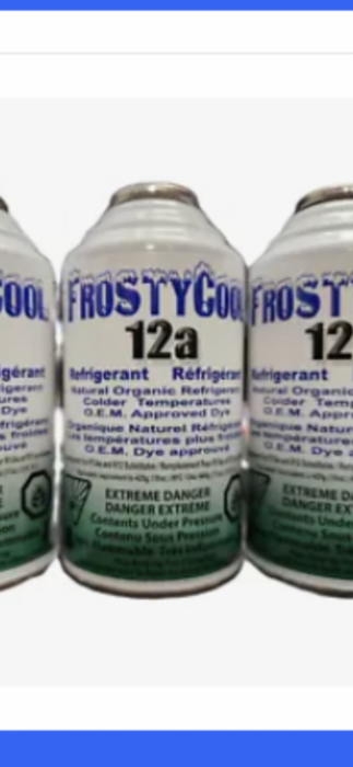

Gregoryb Posted November 21 Topic Author Share Posted November 21 I bought some of that 12a organic stuff that’s supposed to work and mix with Freon… well it don’t cool like r12 Freon so I bought some expensive r12 from a guy 4 cans. Link to comment Share on other sites More sharing options...

Gregoryb Posted November 21 Topic Author Share Posted November 21 I figured since it’s organic and safe I’d let it out and put the good stuff in. Link to comment Share on other sites More sharing options...
Gregoryb Posted November 21 Topic Author Share Posted November 21 It don’t cool like r12 Freon. Link to comment Share on other sites More sharing options...
Ronnie Posted November 21 Share Posted November 21 1 hour ago, Gregoryb said: I bought some of that 12a organic stuff that’s supposed to work and mix with Freon… well it don’t cool like r12 Freon so I bought some expensive r12 from a guy 4 cans. Rarely does a cheap alternative work as well as the real thing. Hope the R12 works out for you. 1 Link to comment Share on other sites More sharing options...

Gregoryb Posted November 21 Topic Author Share Posted November 21 I’m sure kicking myself for putting that 12 organic crap in I was just low not leaking 😡 Link to comment Share on other sites More sharing options...
Gregoryb Posted November 23 Topic Author Share Posted November 23 So I let the crappy organic stuff out and replaced with the good stuff it took more cans from empty then I thought. It took 5 cans to get the pump to stop kicking in and out and put one more in to put me at 35 psi man what a difference ice ice baby! Way cold now. 2 Link to comment Share on other sites More sharing options...
