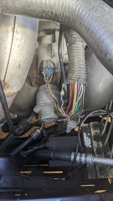

Pices73 Posted November 22, 2023 Topic Author Share Posted November 22, 2023 This is the purple black wire. That I do not have plugged in. The transmission doesn't need it to work. Link to comment Share on other sites More sharing options...
