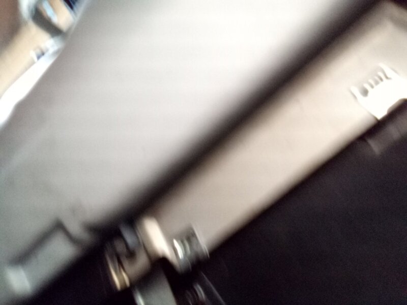

Top Down Posted November 7, 2023 Topic Author Share Posted November 7, 2023 The struggle continues. Under the dash for a 3rd time only to find something different. Instead of 4 torx screws, there are 2 clips as seen in the picture. These clips are wedged between the black cover and a cross member which has provisions for the 4 torx screws. Could not remove these clips as they are tightly mounted over slots in the cross member and compress against the black cover. Any ideas as to removing these clips as prying with a screw driver doesn't work...........? Link to comment Share on other sites More sharing options...

Philbo Posted November 8, 2023 Share Posted November 8, 2023 22 hours ago, Top Down said: The struggle continues. Under the dash for a 3rd time only to find something different. Instead of 4 torx screws, there are 2 clips as seen in the picture. These clips are wedged between the black cover and a cross member which has provisions for the 4 torx screws. Could not remove these clips as they are tightly mounted over slots in the cross member and compress against the black cover. Any ideas as to removing these clips as prying with a screw driver doesn't work...........? I did this repair on mine. It was a while ago but I do not recall having to take those clips off. There is not much disassembly needed to get to them but they are hard to reach. They reside in some metal clips, I'd like to say I used a long screwdriver to pop them out and something like a bent coathanger to pull them down. Getting them back in the clips was not easy, though I did eventually get it. Let me look back at my pictures and see if I can find any from when I did it. Link to comment Share on other sites More sharing options...
Philbo Posted November 8, 2023 Share Posted November 8, 2023 I unfortunately cannot find those photos. I think I took them with my camera instead of my phone and I cannot find that memory card. However I did find these. These were the only two pieces of trim I had to remove to get to them. Then you have to lie awkwardly on your back and look up to the passenger side of the steering column. Any long screwdriver or extra long nose pliers etc. that you can employ to help you is good. If I recall I could squeeze my hand up and touch them. I will also say, the seats are really easy to remove and re-install if you wanted to do that to give yourself more room to lie down to work. 1 1 Link to comment Share on other sites More sharing options...
