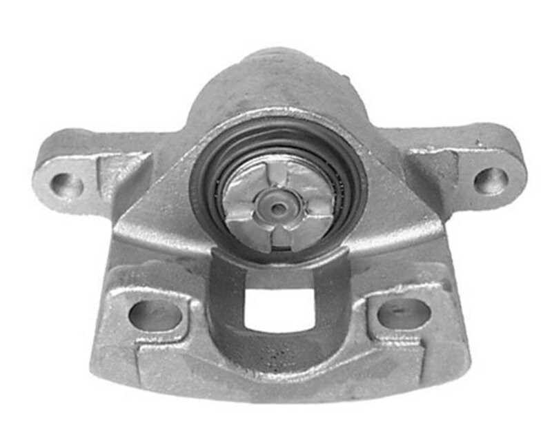

Ronnie Posted September 17 Share Posted September 17 3 hours ago, TripleC321 said: This adjuster screw is in both rear calipers correct? Correct. The photo below shows the adjuster parts inside the caliper. The adjuster screw is what the parking brake arm on the back of the caliper bolts to. It screws out of the T-nut to adjust the travel of the piston as you use the parking brake. Since I never had any problem with it I don't know what you would need to do to get the adjuster working properly if that is the cause of your problem. I assume you would have to take the piston out of the caliper to get at it so you can clean it up. Thanks to Barney Eaton for the photo. 1 Link to comment Share on other sites More sharing options...

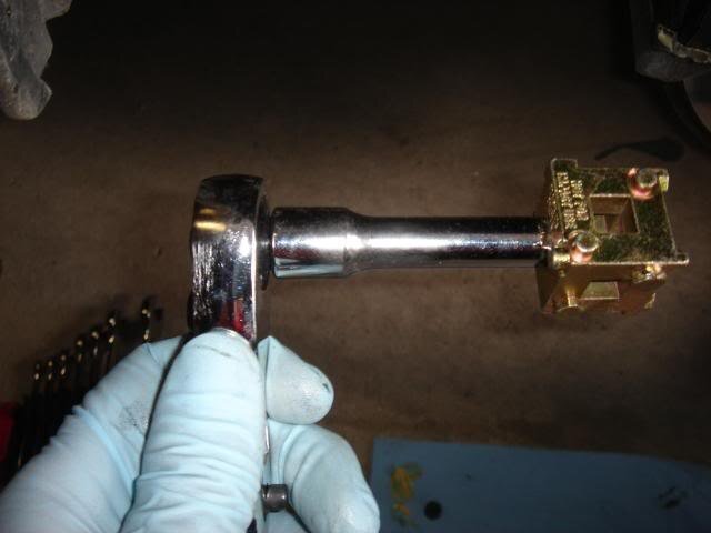

Ronnie Posted September 17 Share Posted September 17 A tool like this is used with a ratchet and extension to screw the piston in on the adjusting screw to move the piston in far enough to get the new pads installed. The piston has notches on the face of it that the tool fits into in order to turn the piston. You can do it without the tool but it makes the job easier. Link to comment Share on other sites More sharing options...
