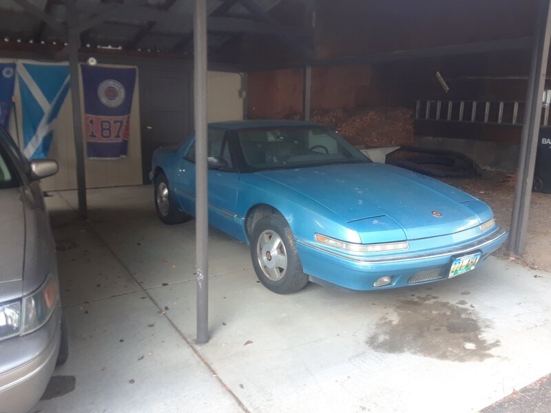

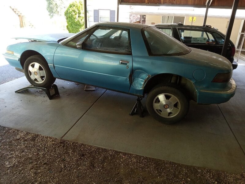

derdachshund Posted July 18, 2023 Share Posted July 18, 2023 Hello, long time reader, first time poster. (Yes, I’ve been through all 93 pages of this forum, researching!) Been a long road back from the dead for the ’90 light blue Reatta. (I’ll make a separate thread on the back story) It’s not in good shape, but I’ve fixed many things, and am down to the last big hurdle…..yes, the brakes. Right now they do not have any boost, so they are hard to apply, but do stop the car. You just need to be Magillah Gorilla to do it. The pump never ran when I first got the car running. I’ve done a lot of testing/trouble shooting and finally just jumped 12V from the battery to the pump and the pump is dead/stuck. So I need a new one. I know it’s an “assembly” with the switch and accumulator. It’s probably not beyond me to just take the pump off and apart and see what’s going on. It’s also not beyond me to do the S-10/Riviera booster, master swap, although it looks like the Rivi booster is a bit scarce. Any sources (or if anyone has a good one laying around) for the pump would be appreciated. Anyone whose done a swap feel free to chime in, too. Thanks -derdachshund Link to comment Share on other sites More sharing options...
