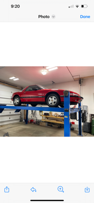

Gregoryb Posted July 22, 2023 Topic Author Share Posted July 22, 2023 Fred gets his new fuel pump today hope it fixes him Link to comment Share on other sites More sharing options...
Gregoryb Posted July 22, 2023 Topic Author Share Posted July 22, 2023 The guy replacing my fuel pump noticed my fuel pump Pulsator seals are rotted and probably was my leak problem Link to comment Share on other sites More sharing options...
Gregoryb Posted July 22, 2023 Topic Author Share Posted July 22, 2023 The mechanic was impressed by the single rear mono leaf spring Link to comment Share on other sites More sharing options...
Ronnie Posted July 22, 2023 Share Posted July 22, 2023 49 minutes ago, Gregoryb said: The guy replacing my fuel pump noticed my fuel pump Pulsator seals are rotted and probably was my leak problem That makes sense. Did he replace the pulsator with a piece of fuel line included with the pump to eliminate that problem in the future? Link to comment Share on other sites More sharing options...
Gregoryb Posted July 22, 2023 Topic Author Share Posted July 22, 2023 I just told him to do it he wanted to go stock with a new pulsator so it’s ok to bypass it with the fuel line? Link to comment Share on other sites More sharing options...
Ronnie Posted July 22, 2023 Share Posted July 22, 2023 I had the guys that installed my fuel pump use the short piece of the hose on mine. I think it makes a tighter connection if clamps are installed properly. The pulsator was used to quite the pump. Noise was not a problem with the hose. either one will work. Link to comment Share on other sites More sharing options...
