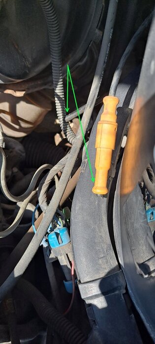

Ohjai Posted June 13, 2023 Topic Author Share Posted June 13, 2023 Could this be the ABS sensor wire? If not, do you have any idea where the other end is connected? Jim Link to comment Share on other sites More sharing options...
Ohjai Posted June 13, 2023 Topic Author Share Posted June 13, 2023 (edited) The ends of the black wire read 1,560 Ohms, the internal to the over sheath is brown/white stripe and black. It disappears into the strut tower, heading to the wheel area. it appears the yellow connector wire goes into the cabin. Edited June 13, 2023 by Ohjai Link to comment Share on other sites More sharing options...
DAVES89 Posted June 13, 2023 Share Posted June 13, 2023 That is a good number. There is a lead on the drivers side and passenger side. there are also one on each wheel in the rear of the car. I would check them all. 1 Link to comment Share on other sites More sharing options...

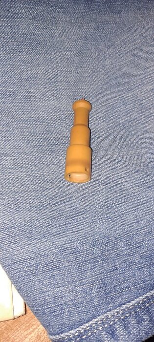

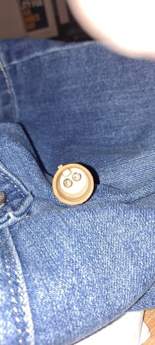

Ohjai Posted June 14, 2023 Topic Author Share Posted June 14, 2023 Not a coax. Two individual wires in a sheath. One is tan, the other is black. The connector is yellow with 2 connections inside of it. Link to comment Share on other sites More sharing options...

Ohjai Posted June 14, 2023 Topic Author Share Posted June 14, 2023 It is 2 wire with an outer plastic covering. I just pealed back a half inch or so and it does not appear to be shielded going into the cabin. Link to comment Share on other sites More sharing options...
