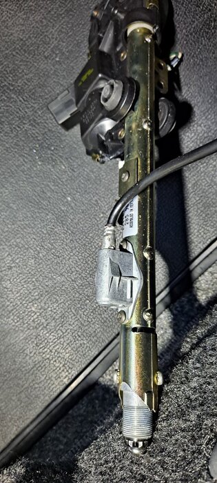

I have the antenna loose from the body, but the antenna connector does not want to separate from the antenna housing.  Is it just tight, or is there a pigtail connection somewhere between the antenna and the radio?
Trace back about 2 feet from the antenna body and you should see a connector.
I just pulled the antenna cable out of the black sheath to just almost where it enter the passenger compartment.  No connector.  I hope I don't have to disassemble the entire car to change the antenna.  I suppose I could cut it and put connectors on it, but I have gotten rid of all my coax tools and spare connectors.
In my past life I repaired commercial radios and radios, plus I am a Amateur Radio Operator  N0OBG.
Seems like you should be able to remove two screws and take the coax connector off the antenna.
The Coax on mine is at 90 degrees covering up one of the screws.
I'm no expert on Reatta antennas but that doesn't look like any Reatta antennas I've seen before.
  • 5 months later...
U discovered the antenna connector just pulls out at the antenna.  I was just a tight finning connector and I did not want to brake it.
