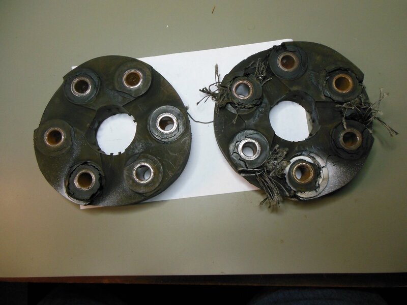

Ronnie Posted August 19, 2023 Topic Author Share Posted August 19, 2023 On 6/18/2023 at 2:08 PM, Ohjai said: Yes Ronnie, that's what they are called flex couplers, I have always had difficulty recalling the name of parts, but I have managed. We were on a Rolls tour in Florida a few years ago. A couple from Virginia had a vibration when they arrived in At. Augustine. About five miles from the hotel on the first day, he is pulled along side of the road. The flex coupling had failed, resulting in the transmission being driven up through the floorboard tunnel. Needless to say his tour ended, and his car towed back home. When you replace them, use new grade 9 bolts (the black ones). Also, the bolts go in a certain direction, there are arrows indicating the direction. But those buggers are tight. Using softer bolts will not stand up to the torque over time. Keep in mind they are made of material that degrades with age, NOS probably is not a good idea. Thank you for alerting me to this problem and for the tip about the bolts. I checked my flex discs and the front one is needing to be replaced. Although I couldn't see any cracks in the rubber, the front one has rust showing around the steel inserts where the bolts go through. I've read on the MB forums that's one of the first signs (besides obvious cracks) that the flex disc is going bad. The rear one looks good. I think it might have been replaced at the MB dealership. I believe I saw something about it in the service records I got with the car. I will be changing both, front and rear flex discs, as well as the transmission mount, while I have the car off the ground. All are relatively inexpensive and fairly easy to replace. I don't want to take a chance on the same thing happening to me that happened to the coupe from Virginia. If the front one goes out on a MB like mine it can take out the the transmission tail shaft housing, the transmission mount and crossmember, all the shifter linkage, warp the driveshaft, and beat the sheetmetal under the car all to hell. All of that over a part that costs less than $100 going bad. As far as I can tell, the center support of the two piece driveshaft is in good condition. That's good because the exhaust system has to come off to get at it. Even though the exhaust doesn't have any rust on it, I don't like dealing with exhaust systems unless it's absolutely necessary. Seems like exhaust system bolts like to seize and break for no reason. 1 Link to comment Share on other sites More sharing options...

Ronnie Posted October 5, 2023 Topic Author Share Posted October 5, 2023 Thanks for asking Dave. I didn't think anyone here would care about my new toy. Mechanically there are no issues. I checked the rubber flex disks on each end the driveshaft that I was worried about and they were good. I think they must have been replaced by the Mercedes dealer at some point because they are known for the rubber cracking when they get old. Mine has no cracks at all. The engine starts and runs perfect. Even though I just use it for evening drives and short trips on the weekend like I did the Reatta, I wouldn't be afraid to drive it anywhere. Power delivery is surprisingly good considering it's a 2.2 litre four cylinder engine. Like the Reatta, it has plenty of low end torque, but it also likes to turn a lot of rpm if you want it to. It's a lot of fun to drive but it's not a hotrod. Fuel mileage is good, 30-33 MPG is normal driving around town and the backroads (Reatta got about 22), but that is offset somewhat by having to use Premium fuel that costs 60-80 cents more per gallon than regular. Last time I filled up I paid $4.01 per gallon for Shell. Regular would have been $3.22. Outside it looks really good when it's clean (black paint is hard to keep looking that way). I spent a lot of time using a clay bar on the paint. Now the paint is as smooth as a baby's butt. There are still some rock chips and scratches that I wish weren't there. I touched them up and they look pretty good. When talking with a friend on the phone, who built and painted his Shelby Cobra replica, I told him I thought it would pass the 10 foot rule when looking at it. When he saw it at a local car show he said he thought it would pass the 2 foot rule. That made me feel good about it. Everything inside the car works as it should except the fuel gauge. It's very erratic and can't be relied on. For the most part the interior looks almost like new, with the exception of the drooping headliner that I have pinned up for now. No one notices it unless I point it out. I might take it out and have it recovered this winter. Not decide for sure yet about that. It's like a Reatta. when you start removing plastic trim parts to get the headliner out you run the risk of breaking a lot of stuff that might be hard to find and replace. Not many Mercedes in the junk yards around here. 1 Link to comment Share on other sites More sharing options...
