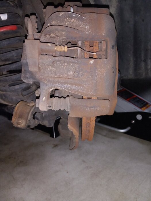

Ronnie Posted June 22, 2023 Topic Author Share Posted June 22, 2023 I started to change the front brake pads on the MB this morning. When I started looking at what needed to be done to replace the pads it looked simple at first, and then I discovered that one of the pads has an electric wire going to it from a connector on the knuckle. I think it has an electronic wear indicator that turns on a light on the dash when the pads get worn down to a certain point. First time I've ran into this so I'm going to have to do some reading to find out how it works before I take it apart. I'm sure there will be a YouTube video that shows what I need to know. MB guys like to do YouTube videos.... lucky for me since I know very little about a MB. 1 1 Link to comment Share on other sites More sharing options...
Ronnie Posted June 23, 2023 Topic Author Share Posted June 23, 2023 I finished the front brakes up today. It turns out the brake pad wear sensor has a tiny rod that sticks down into a hole in the pad. A lead coming off the sensor plugs into a connector on the knuckle. When the pad wears down enough that the sensor rod touches the rotor it grounds a circuit that tells the brake computer to turn on a light on the dash. It's a stupid waste of engineering time and money that's not needed as far as I'm concerned. The squealers that are on the GM brakes work just fine to warn you when the brake pads are worn out and are much simpler. Link to comment Share on other sites More sharing options...

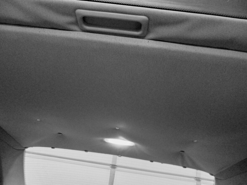

Ronnie Posted June 23, 2023 Topic Author Share Posted June 23, 2023 I also did some work on the headliner today. I added some buttons that screw into the headliner board to hold the cloth up. Yeah, it's a half-ass job. It will do until I decide if I want to get someone to fix it right. Nobody looks up at the back of the headliner so I might just leave it like it is for a while. Link to comment Share on other sites More sharing options...
Ronnie Posted June 23, 2023 Topic Author Share Posted June 23, 2023 11 minutes ago, 2seater said: Is that a solution to a problem, or question, no one asked?? Maybe the engineer that designed that was deaf so a visual clue was needed?🤣 I think some engineer's brother-in-law had some sensors he needed to sell. 🙂 You can see the sensor in this photo I took before I took anything apart. The sensor plug is yellow in the center of the photo. You can see the white lead going over to the sensor in the outside pad on the right. As I said before, I think it's stupid. Link to comment Share on other sites More sharing options...
