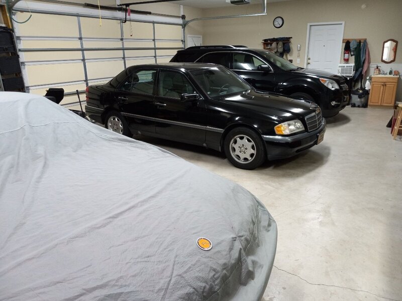

Ronnie Posted June 6, 2023 Topic Author Share Posted June 6, 2023 I finally got a little time to work on the Mercedes today. I installed the new fuel filter and fresh gas. After purging old gas and air in the fuel line through the Shrader valve I turned the key and it fired right up. I drove around a few minutes and got a check engine light. Scanner showed a code P1444. Mercedes guys say it is common and usually caused by a bad vacuum line going to the purge valve, or it could be a bad purge valve. I cleared the code and so far it's not came back. I've not driven it much on dry rotted tires. I've decided my speed limit is 45 mph until I get some different tires. I hate the black paint. Every time I tough it the damn thing it makes it look dirty. 🙂 Below is a photo of how I think a Mercedes is supposed to look in a garage. Only thing missing is a mechanic (me) laying under it. Kind of reminds me of a Reatta. lol 3 1 Link to comment Share on other sites More sharing options...

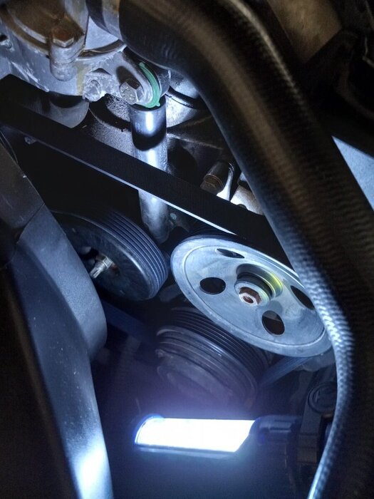

Ronnie Posted June 18, 2023 Topic Author Share Posted June 18, 2023 2seater, your post got me to wondering about the little shock so I went to rockAuto to get a look at it. They list it as a belt tensioner damper. I looked under the hood of my Mercedes and they are correct. It goes between a bracket on the block and the belt tensioner pullly as shown in the photo below. I've not saw the little shock on a Reatta. My '88 doesn't have one. From what I've read and photos I've seen I envision the one on the MB to be much bigger than the Reatta. It is about 9" long, about 1-1/4" in diameter and has an eye mount on each end. I wonder if that is the one some people use to replace the little shock on the Reatta engine? Link to comment Share on other sites More sharing options...
