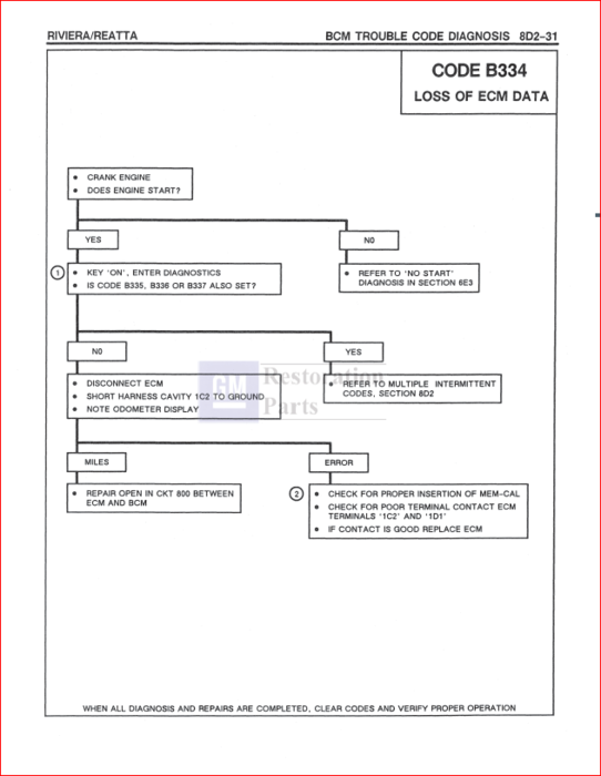

Sorry to hear that. I've never heard of anyone getting that code. Below is the troubleshooting flow chart for an '89. I think it is probably the same as your '90. Maybe it's just a bad connection.  Hope it helps.

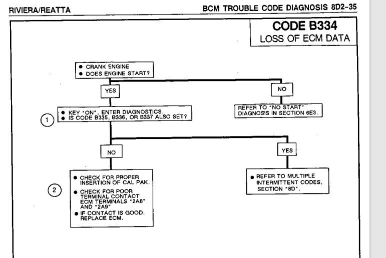

Ronnie posed the info for an 89, this is from the 91 manual.  Hope it helps.
I switched them a couple of times today. If i use the old computer I don' t get the B334 code but I also don't get the O2 sensor data and it dies. If I use the new,refurbished one, it runs but I get the B334 and no Rpm, speed, temp or ac. Did the connections several times and only get the E data loss with new computer so probably the new ECM and not the wiring. Guess I'll try another ECM
