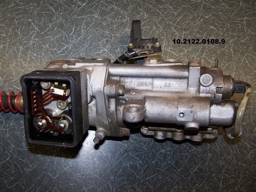

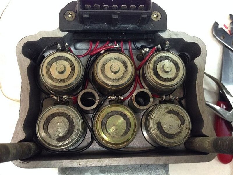

mjac Posted May 30 Topic Author Share Posted May 30 (edited) I found a photo of the solenoid valves for the Teves II Mark 2 ABS System. This photo is from a 1990 Jaguar. I may try removing the ABS unit and check the connections to the solenoids. I could solder a broken one if I see one. I think Front valves are on the top, Rear valves on the bottom. This might be enough to fix the issue. If not, it looks like I will need a replacement ABS unit. Has anyone had success with this? Edited May 30 by mjac added a photo Link to comment Share on other sites More sharing options...
2seater Posted May 30 Share Posted May 30 No experience taking one apart and I believe you venturing into unknown territory. As far as I know, the valve module itself is replaceable but no idea of a source except used takeoffs. Best of luck and I am very interested in what you find. 1 Link to comment Share on other sites More sharing options...

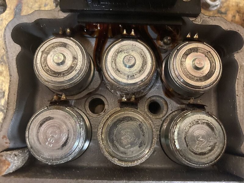

mjac Posted May 31 Topic Author Share Posted May 31 (edited) Nice find on that pinout diagram, Ronnie! Thank you. I removed the valve body cover and had a peek inside. It looks a lot like the pic below of the Teves Mark 2 valve body from a Jaguar. With the Ohm Meter, I checked the continuity of each of the connections. They had resistance between 6.4 - 7.0 Ohms. Except for one, which read 4.8 Ohms, but I found no open circuit, thankfully. Those ribbon cables look pretty flimsy though. If I were to take out the valve body, I would replace them with wire. It was getting late, so I didn't remove the valve body which would require a lot more work, especially since there didn't appear to be any broken connections. There wasn't a gasket or seal of any kind on the cover, which I thought was kinda odd. Anyway, the valves looked good (no rust) so apparently, water getting in there isn't an issue. I pressurized the accumulator by pumping the brake pedal (engine off) till I felt some pushback. I took it for a quick spin, and to my delight, the ABS light which has plagued me since I bought the car, was OFF. Yippee! Not sure what happened. I may have reseated a crummy connection when I was poking around the ribbon cables. Anyway, we'll see how long it lasts. Thank you for your help. I learned a great deal more about my Reatta. My next repair will be to replace the nearly disintegrated vac hoses on the speed control. The computer is prompting me to fix it far too often. Edited May 31 by mjac 1 Link to comment Share on other sites More sharing options...
Ronnie Posted May 31 Share Posted May 31 That's good news. I'll bet the problem was a bad connection. The ABS valves seldom give trouble. 1 1 Link to comment Share on other sites More sharing options...
