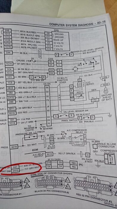

Howdy2k2000 Posted May 25 Share Posted May 25 (edited) I have no IPC illumination and will update when fixed. This pic is from my 1988 Service Manual. I found on my car that Cavity RTC is actually in RTD, which is a Dark Green Ground but I added the ground to RTC with no change. Just an FYI that the Service Manual seems wrong for at least that pin (cavity). Edited May 25 by Howdy2k2000 Added info Link to comment Share on other sites More sharing options...
Ronnie Posted May 25 Share Posted May 25 1 hour ago, Howdy2k2000 said: I have no IPC illumination and will update when fixed. This pic is from my 1988 Service Manual. Welcome to the forum Howdy! Give us the page number you are looking at in the Service Manual and I will look it up . Link to comment Share on other sites More sharing options...

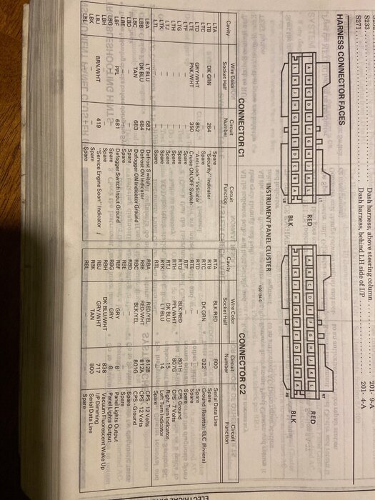

ClaretRed89 Posted May 27 Topic Author Share Posted May 27 Hmm.. the flickering happens even when the engine's off, the instrument panel flickers when I put the car in ignition and turn parking lights on. Thanks @Howdy2k2000 for the picture: if you look at the c2 connector, the serial data line and instrument panel dimming lines are neighbors on that connector. That's why I still think it's a short or a bad connection. The flickering starts and then the computer throws a "connection problem detected" message on the CRT (and in I get the B336H code in service mode). Anyway, I have an appointment with my mechanic. We will disassemble the dash and report back. Concerning the daytime running lights: the option1 override code (BS06/BD90) seems to work. Before, with the standard US code, the car would revert to imperial each time I disconnected the battery. With the CAN/export code the car now starts with metric displays as soon as I reconnect the battery. I guess it knows it's an export car now. But no lights. I guess the previous owner must have tampered with them. I don't hear relays clicking either when I set the override code. I guess we will look at the internal relay box too to see if some relays are missing. Too bad DRL is undocumented in the service manual. Thanks you all for the help!! Link to comment Share on other sites More sharing options...
