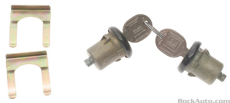

Ronnie Posted April 8, 2023 Share Posted April 8, 2023 21 minutes ago, Ohjai said: can reach my arm up to the lock cylinder and found the the retainer with switch and connector hanging loose. I push the retainer on but the push button springs it back off. I've not had that apart but just wondering, are you putting the spring clip in the notch on the cylinder to hold it in place? Link to comment Share on other sites More sharing options...

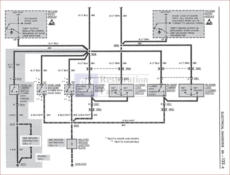

Ohjai Posted April 8, 2023 Topic Author Share Posted April 8, 2023 Sort of what you are showing, but my clip has a spring loaded switch at the curve of the clip. The pressure of the switch is preventing the clip to stay in place. Looking at the wiring diagram, it appears this is a part of the anti-theft system. If somebody pops the lock, the switch closes causing something to happen down stream. Since the clip was not on the cylinder, I am considering removing the switch jumping the wires so the system thinks the lock cylinder is in place. I am unable to see how this was to stay together. Looking at the manual, it appears simple enough, but I am missing something. Link to comment Share on other sites More sharing options...

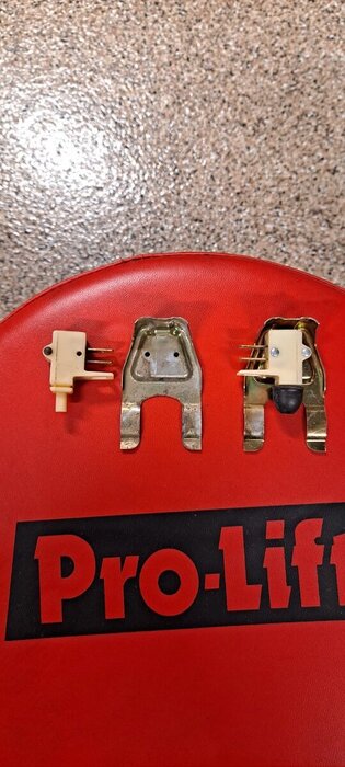

Ohjai Posted April 8, 2023 Topic Author Share Posted April 8, 2023 I drilled out the mounting rivets that holds the switch on bracket, then it looked a lot like your picture above. Snapped it in over the door lock cylinder, removed the switch from the car, and now the annoying security light goes out when I shut the door. I really appreciate the assistance I get from this forum. Again a BIG THANK YOU. jIM 2 Link to comment Share on other sites More sharing options...

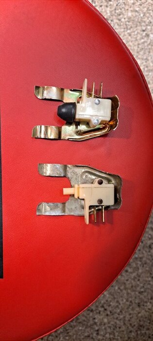

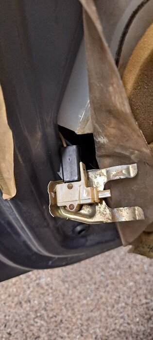

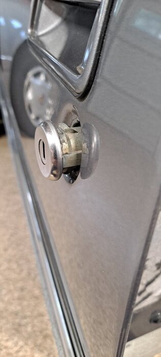

Ohjai Posted April 16, 2023 Topic Author Share Posted April 16, 2023 As you can see, the driver door lock is loose. When I pushed the bracket over the lock, the pressure from the switch would push it off, I was unable to get it to stay in place. Ordered a new switch/bracket from North East Reatta Parts, and had the same issue. After drilling the rivets holding the switch, I pushed the bracket on the lock and it snapped into place. By leaving the switch disconnected I removed the anti-theft feature of alarming the car when the lock cylinder is removed. I have added some pictures to help visualize my fix for the door lock and security issue. 1991 Reatta Door Lock Picture Marked.pdf1991 Reatta Door Lock Picture Marked.pdf1991 Reatta Door Lock Picture Marked.pdf1991 Reatta Door Lock Picture Marked.pdf1991 Reatt Door Lock Cylinder Alarm Schematic Marked.pdf1991 Reatt Door Lock Cylinder Alarm Schematic Marked.pdf Link to comment Share on other sites More sharing options...
