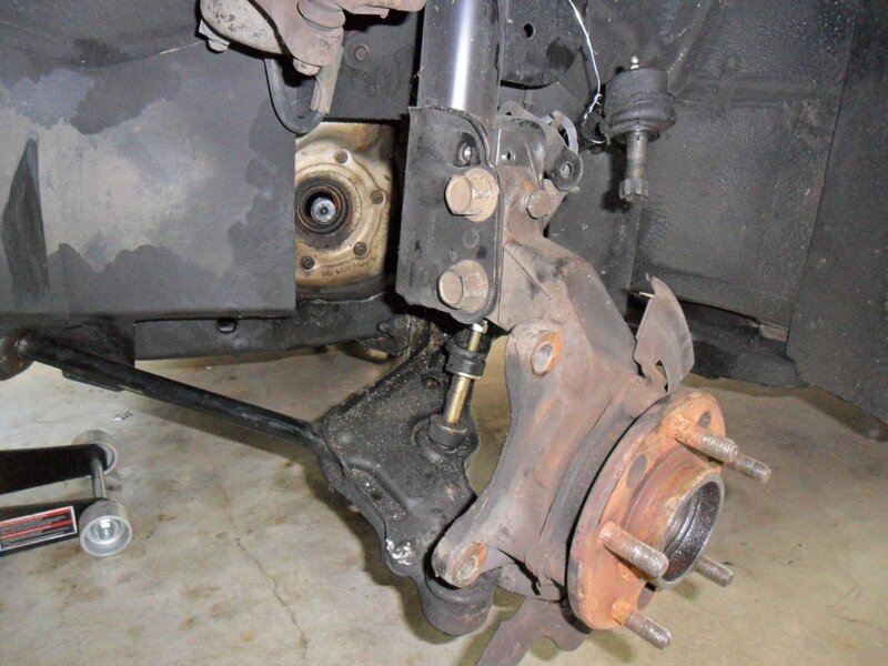

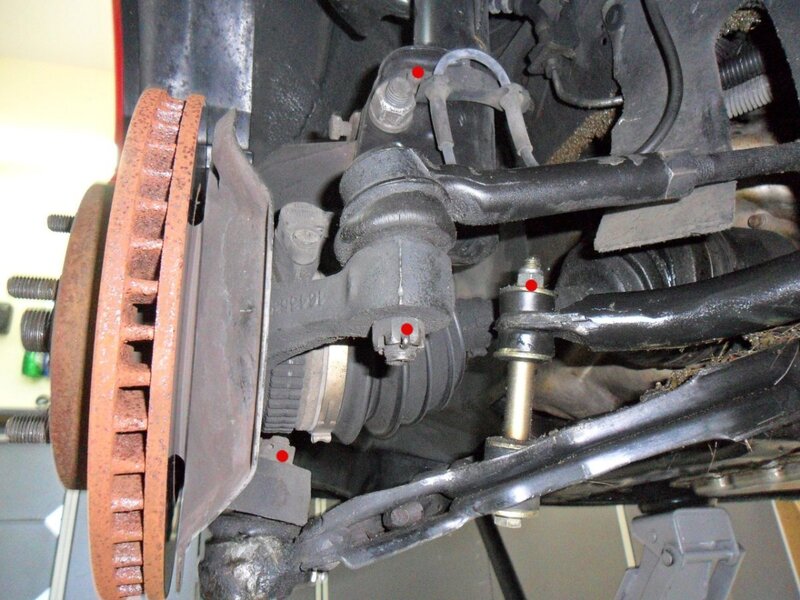

Ronnie Posted April 22, 2023 Topic Author Share Posted April 22, 2023 I got the old axle out today and decided to stop for the day. Next step will be to clean up all the grease the slung out of the old axle and then put the new (to me) axle in. Hard part so far was getting the lower ball joint loose and getting the axle out of the transmission. Getting the ball joint out of the knuckle is hard because the brake reaction rod or rubber bushings on the lower control arm wants to keep the control arm and ball joint pushed up against the knuckle. All that holds the axle in the transmission is a C clip but it snaps in really tight making the axle hard to get out. I took lots of photos. Here are a few of them. Not many tools needed really. Had to get the large 36mm socket as a loaner from AutoZone to remove the axle spindle nut. This photo has the nuts you have to remove marked with a red dot. Top red dot is a bolt that holds the ABS sensor to the strut. Removed it to prevent the sensor lead from getting in a bind. Not shown are the bolts that hold the brake caliper bracket on and the one that holds the bracket for the brake hose to the strut. Those bolts are on the other side of the knuckle. Everything loose and the axle removed. Ready for grease cleanup and installing the other axle. 2 Link to comment Share on other sites More sharing options...
Ronnie Posted April 24, 2023 Topic Author Share Posted April 24, 2023 Finished the axle replacement today. I spent at least an hour under the car cleaning off grease slung out of the cracked boot on the axle. It's terrible grease that just want to smear instead of wiping off easily. Luckily what slings out isn't in a place that can be seen from under the hood or inside the fenderwell. 2 Link to comment Share on other sites More sharing options...
