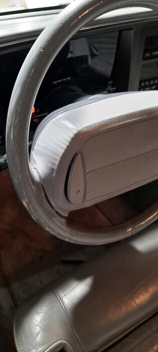

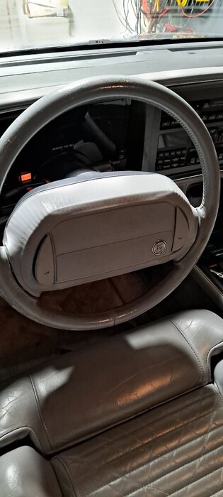

Ohjai Posted March 31, 2023 Topic Author Share Posted March 31, 2023 By using my Power Probe I found out why the horn is not working. Well it does but the plastic buttons on the steering wheel are not properly seated. both sides have been pried out of the housing and I cannot gently get them to snap back in place. Dos anyone have a suggestion on the trick to hold my mouth while looking cross-eyed and my tongue hanging out like Patrick Mahommes.? Link to comment Share on other sites More sharing options...

Ronnie Posted March 31, 2023 Share Posted March 31, 2023 1 hour ago, Ohjai said: By using my Power Probe I found out why the horn is not working. Well it does but the plastic buttons on the steering wheel are not properly seated. both sides have been pried out of the housing and I cannot gently get them to snap back in place. Dos anyone have a suggestion on the trick to hold my mouth while looking cross-eyed and my tongue hanging out like Patrick Mahommes.? A photo of your buttons might help. My Reatta doesn't have the airbag steering wheel so I can't offer much help. Link to comment Share on other sites More sharing options...
Ohjai Posted March 31, 2023 Topic Author Share Posted March 31, 2023 Photos of my horn buttons. 1991 Link to comment Share on other sites More sharing options...
sarookha Posted March 31, 2023 Share Posted March 31, 2023 There's some info in the ROJ How-to guides on horn buttons, they were problematic. You may be able to carefully remove one, after looking through the diagrams in the How-To, and see if manually pressing on the pressure switch underneath activates the horn. Link to comment Share on other sites More sharing options...

Top Down Posted March 31, 2023 Share Posted March 31, 2023 Regarding the position of the horn buttons, the picture shows that they are sort of sticking up. Although this seems to be odd, the horn buttons on the '90 and '91 Reattas do in fact stick out. That is their normal position and never are fully seated until they are depressed when sounding the horn. The typical problem with the horn buttons is that they break when too much force is used on them. 1 Link to comment Share on other sites More sharing options...

Ohjai Posted April 8, 2023 Topic Author Share Posted April 8, 2023 Following the directions given on this Forum for removing the horn button/switches, I now have a fully functioning horn. Jim 1 Link to comment Share on other sites More sharing options...
