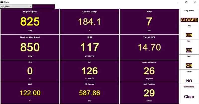

Padgett Posted February 14, 2023 Share Posted February 14, 2023 Hoo boy, let's just say I sent Ryan all of the Reatta PROM dumps. Most of my work has been done on a (now) Windows 11 desktop with a 32" monitor. Understand the ALDL to USB device now comes from Red River or TunerCat I use a Windoze tablet with touchscream for in-car display. The following is one I programmed using TunerPro RT Tuning info is from TunerCat who seems to have take over from Moates.net which is closed. I have a Pocket Programmer III (USB) from XTRONICS but had trouble connecting. May have to check eBay. Link to comment Share on other sites More sharing options...
