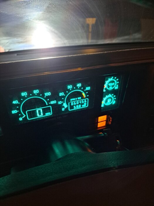

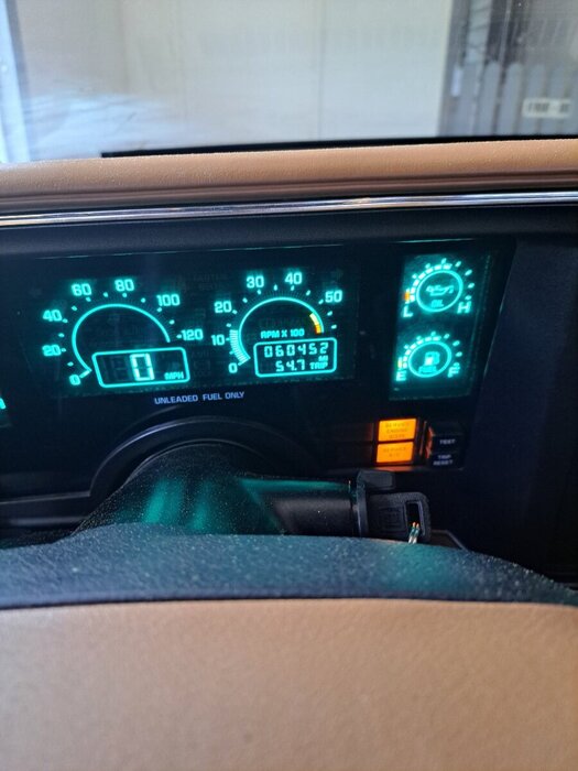

jg2003 Posted February 6, 2023 Topic Author Share Posted February 6, 2023 Okay so whenever the car exits the no rpm display mode and the reading returns it usually sits at around this Then the car calms down and idle lowers to about this Link to comment Share on other sites More sharing options...

jg2003 Posted February 6, 2023 Topic Author Share Posted February 6, 2023 (edited) 5 hours ago, Ronnie said: I think the ICM could cause the problems you have but lots of other things could to. Replacing the ICM with a known good one is the best test. The ICM could account for the tach reading going out as well. The next time it goes out, wiggle the connector on the ICM and see if it starts working. When the idle goes out you can go into diagnostics and look at ED11. It should display the RPM. If it does there is probably a problem with communication between the IPC and the BCM (maybe PCM on a '91?). The idle in your photos looks normal. It goes high at startup and then settles down to around 700. That is what mine does on a cold start. No direct video uploads to the forum but you can post a YouTube video. I went into ed11 while the rpm was out and it displayed zero. Also car used to start at first crank now it needs gas input to get it going at all. It sounds super choppy at idle then when it settles it sounds fine however i need to keep my foot on the gas for like 3 minutes for it to stay in idle once I lift off my foot. I'm kinda stumped at this point any ideas?. Edited February 6, 2023 by jg2003 Link to comment Share on other sites More sharing options...
