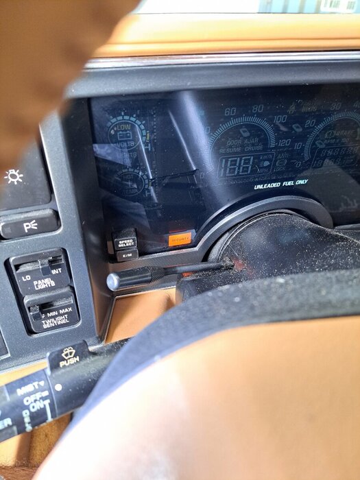

jg2003 Posted January 26, 2023 Share Posted January 26, 2023 Hello all, I have recently become the owner of a 1991 reatta it's a pretty cool car. However I've come across two issues one the car shut down 3 times while driving. It said low oil and completely shut off and left me stranded for a bit however the car definitely had oil. I waited a bit it and it starts again the guy said it might be the fuel pump and gave me a part for it. #1 what do you think the issue might be and #2 how much would it cost?. The second major issue is that the car didn't like being locked and decided to go into the infamous blinking security mode car won't start and the keyfob doesn't do anything. Do I have to reprogram the keyfob or can I just bypass the system and would taking it to a locksmith or car alarm place help? The car is currently giving me headaches -_- Link to comment Share on other sites More sharing options...

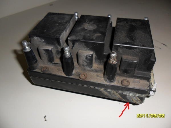

Ronnie Posted January 26, 2023 Share Posted January 26, 2023 Welcome to the forum! 10 hours ago, jg2003 said: It said low oil and completely shut off and left me stranded for a bit however the car definitely had oil. I wonder if the engine had died for some other reason causing there to actually be no oil pressure? It shutting down and then starting again when it cools off sounds more like an ignition problem. Usually the Ignition Control Module (ICM) is the problem. Look to see if you have any gray goo on the side of it like shown in the photo below. Link to comment Share on other sites More sharing options...

jg2003 Posted January 26, 2023 Topic Author Share Posted January 26, 2023 Driver's side door doesn't want to lock with the key only the passenger side door locks and unlocks when I try and crank the car dash lights up and low oil indicator comes on try and crank and nothing happens. The security light keeps flashing even after unlocking the door on the driver's side along with the lights flashing and a tick tock sound which I'm assuming is the relay disabling the starter? Link to comment Share on other sites More sharing options...
jg2003 Posted January 26, 2023 Topic Author Share Posted January 26, 2023 52 minutes ago, jg2003 said: Driver's side door doesn't want to lock with the key only the passenger side door locks and unlocks when I try and crank the car dash lights up and low oil indicator comes on try and crank and nothing happens. The security light keeps flashing even after unlocking the door on the driver's side along with the lights flashing and a tick tock sound which I'm assuming is the relay disabling the starter? Okay figured out the security system with the aftermarket fob was able to crank idled then sputtered Link to comment Share on other sites More sharing options...

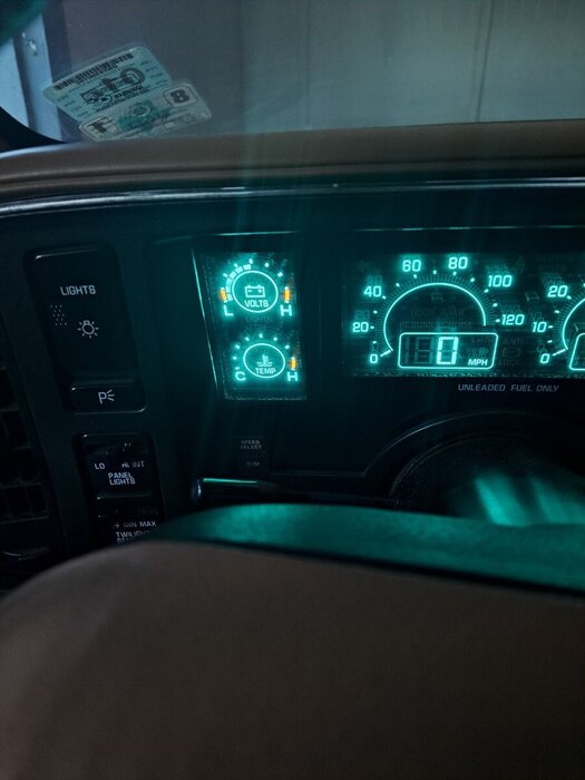

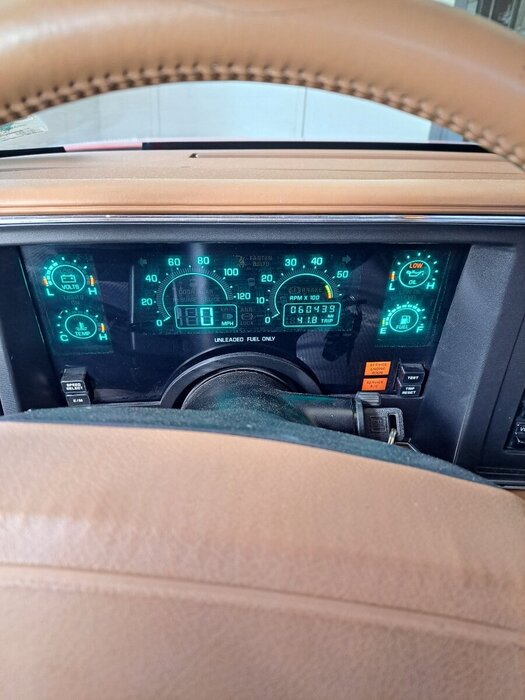

jg2003 Posted January 27, 2023 Topic Author Share Posted January 27, 2023 (edited) Alright MAJOR update car runs however first two cranks it sputtered but on the third crank it got going and idled at 10ish it dipped below that a bit. The first two times it was going then it died out sorta like what happened on the road. I'm getting oil pressure however on one of the starts it started idling but then slowly started lowering oil pressure then it noticeably lost power I turned it off cranked again and it stayed at idle. During the last attempt while at idle at some point the dash stopped displaying rpm then it suddenly came back in the span of 2 minutes the whole time the car was idling no issue. Car was sitting so oil is dirty going to do an oil change on the weekend. Today we ran some fuel system cleaner through it by the end of our test it had started running smoother. The pictures included show idle, when the rpm stopped displaying and should my voltage meter should it be at that level? Edited January 27, 2023 by jg2003 Link to comment Share on other sites More sharing options...
2seater Posted January 27, 2023 Share Posted January 27, 2023 The rpm signal comes from the ICM. Did the engine continue to run without the rpm display? The voltage displayed is normal with the engine running. By and large, the indicators are designed to be at approximately the middle of the range if everything is normal. The fuel level is of course variable. If oil pressure is normal with a proper sender, it rarely deviates one bar higher or lower than center, no matter the rpm or temperature. The pressures mentioned in the above post are for oil pressure, not fuel pressure as I had posted. Any possibility of mouse chewed wiring? Still need a fuel pressure gauge to establish if the pump is at fault or something else. At least it runs, which is a positive. 1 Link to comment Share on other sites More sharing options...

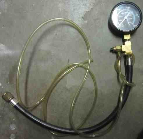

Padgett Posted January 27, 2023 Share Posted January 27, 2023 I just have a good fuel pressure tester from the pre-Kmart Sears. You connect it to the rail shrader valve. Should be 35-40 psi at Idle. Might also check the fuel relief valve for gas in the vacuum line, they fail also. 1 Link to comment Share on other sites More sharing options...
jg2003 Posted January 27, 2023 Topic Author Share Posted January 27, 2023 (edited) Okay so I'm going to buy the gauge and get myself a harbor freight special lol. But quick question I noticed that when the dash stops showing rpm while running the engine sounds louder. And when it shows rpms the engine sounds noticeably quieter. Anyone know why that might be also the car is starting regularly it just takes like two cranks. Also side note is it normal for the car to shake with the engine on? it's noticeable so just thought I'd ask. Edited January 27, 2023 by jg2003 Link to comment Share on other sites More sharing options...
Padgett Posted January 27, 2023 Share Posted January 27, 2023 Never saw a HF gas pressure gauge that didn't leak. Caveat y'all. Link to comment Share on other sites More sharing options...
jg2003 Posted January 27, 2023 Topic Author Share Posted January 27, 2023 1 hour ago, Padgett said: Never saw a HF gas pressure gauge that didn't leak. Caveat y'all. Do you recommend any specific brands? just trying to get one quickly to check the pressure. Link to comment Share on other sites More sharing options...
rogold Posted January 27, 2023 Share Posted January 27, 2023 You might check with your local auto parts store, they may loan you a gauge. 1 Link to comment Share on other sites More sharing options...
Padgett Posted January 27, 2023 Share Posted January 27, 2023 Bought mine in last century, think from Sears Auto. Link to comment Share on other sites More sharing options...
