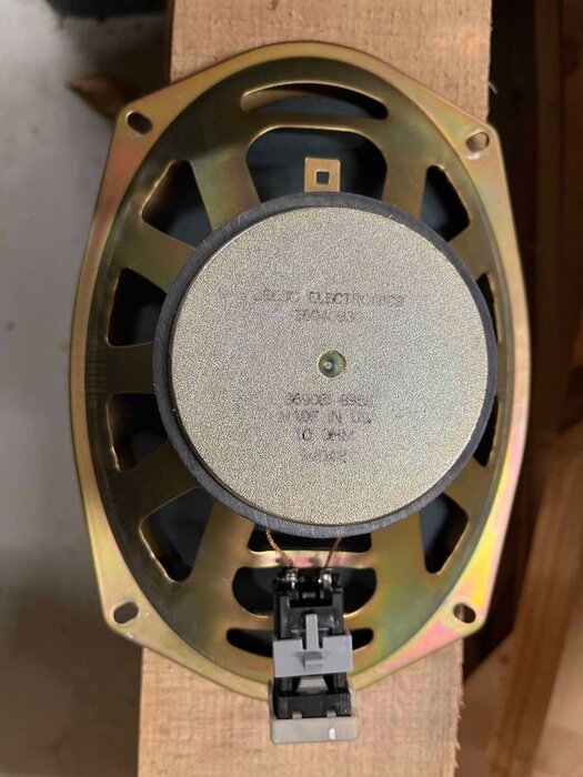

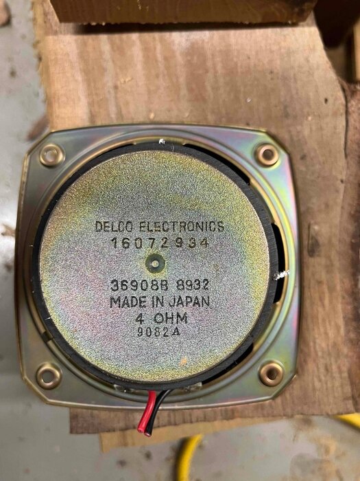

sarookha Posted December 13, 2022 Topic Author Share Posted December 13, 2022 (edited) On 12/5/2022 at 10:57 AM, sarookha said: You probably need to replace the junky Delco paper speakers in your Reatta. But the proprietary 10 ohm front speakers are thin on the ground. To avoid burning out your radio head unit, DO NOT replace the speakers with the more commonly available 4 ohm speakers. Maybe you could use 4 ohm speakers with a 6 ohm resistor wired in series to each front speaker, as long as the resistor wattage was higher than what the speakers would draw? But I found 10 ohm speakers here, and in 5.25" round at that: https://www.smelectrotech.com/product/5-1-4-pin-cushion-single-/3?cp=true&sa=false&sbp=false&q=false&category_id=6 They ain't cheap, and they probably aren't better than the stock speakers that failed you, but maybe they'll give you another 30 years of music before biting the dust. I ordered a pair of generic Pioneer 6X9 4 ohm speakers for the rear, per factory spec. I'll keep you posted. And now that I've got my dead OEM speakers out of the car, they have the opposite impedence of every other Reatta reference I've read. !0 ohm rear, and 4 ohm front. Who knew? I'll install the aftermarket ones in the more orthodox configuration, 10ohm round up front, 4ohm oblong in back. Edited December 13, 2022 by sarookha Link to comment Share on other sites More sharing options...
