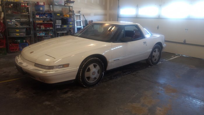

Oceandaemom Posted February 9, 2017 Topic Author Share Posted February 9, 2017 Got these pictures of it today although all the snow on it makes it look pretty rough and sad. I will see about getting a better picture when the snow goes away (hopefully soon). Link to comment Share on other sites More sharing options...

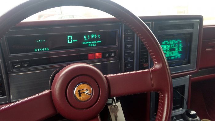

DAVES89 Posted February 9, 2017 Share Posted February 9, 2017 I start telling a cars condition by starting at the steering wheel and that one looks great. Looks like a nice one. Your ABS light is usually one of two things. The relay located on the firewall or a bad lead. Relays are easily obtainable at your local parts store and the lead from a number of vendors [of which I am one of]. It will not affect the driveabilty of your car however you will not have ABS braking. Link to comment Share on other sites More sharing options...
Ronnie Posted February 9, 2017 Share Posted February 9, 2017 Great looking car. I like the white paint with the color matched white trim. Link to comment Share on other sites More sharing options...

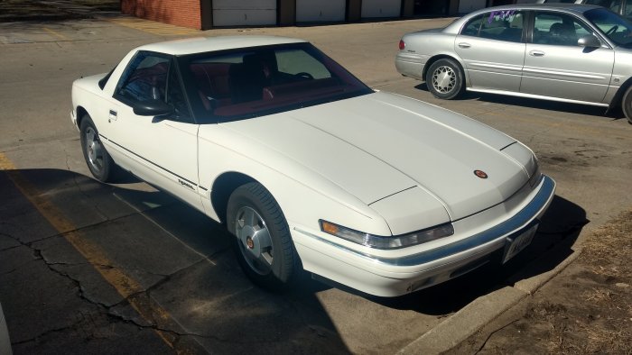

Oceandaemom Posted February 12, 2017 Topic Author Share Posted February 12, 2017 Here are a couple more pictures that I got today since it was nice out and I was doing some work to the car. I found out that the ABS light being on was caused by a loose relay connection to the ABS relay. I pulled the relay out, cleaned the terminals, connected it more securely, and now the light is staying off. Link to comment Share on other sites More sharing options...
