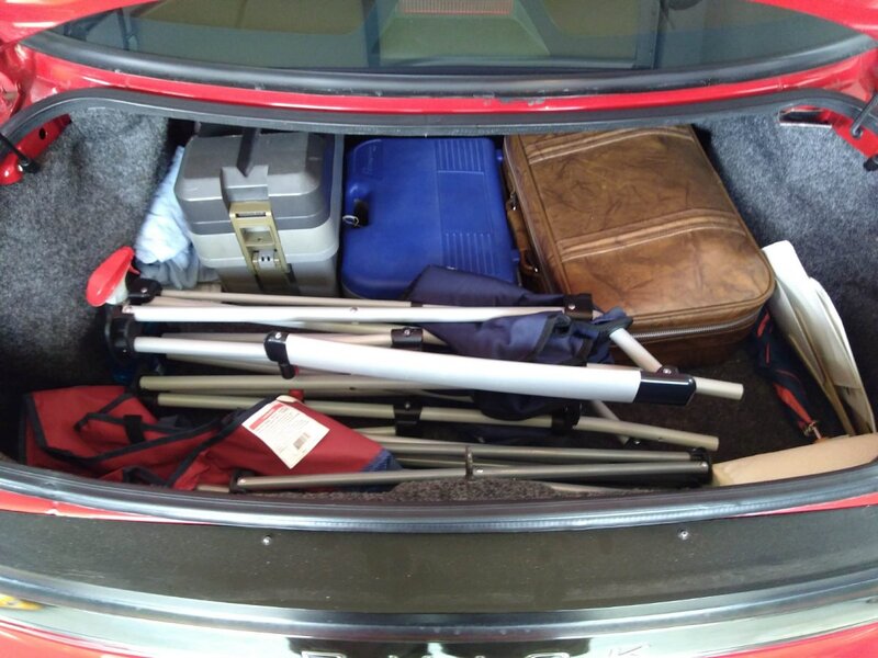

Ronnie Posted September 15, 2022 Share Posted September 15, 2022 1 hour ago, pbtexan said: But I am caught in the issue of "reliability anxiety" regarding these electrical gremlins.... I have a modest tolerance for most issues, but when my wife is traveling with me, she has bad reactions (stress stomach) to breakdowns. Don't give up on it. It's going to be OK. Just make sure you have a cellphone and some necessities with you. AAA is a good thing to have as well. I carry a lot of stuff just in case of a breakdown. Probably too much because my trunk is always full. Lots of tools and FSM for diagnosing problems, jumper cables, lawn chairs, WATER, a few spare parts, and a change of clothes. It's better to have it and not need it, than need it and not have it. 1 Link to comment Share on other sites More sharing options...
Padgett Posted September 15, 2022 Share Posted September 15, 2022 This fits nicely in he trunk. I have several. Is often on sale. 1 Link to comment Share on other sites More sharing options...
pbtexan Posted September 15, 2022 Topic Author Share Posted September 15, 2022 Thanks for the tips on the carb cleaner, will check the fine print ! Re AAA, I have the car now insured with Hagerty's, I'll check but I think the policy includes roadside assistance ! That WILL be more peace of mind. Padgett, nice tool kit !! IS it craftsman, kobolt, harbor freight, northern tool or ? that sells the complete kit. I have most of the parts in my garage, but not in a nice kit form ! Link to comment Share on other sites More sharing options...
Ronnie Posted September 15, 2022 Share Posted September 15, 2022 1 hour ago, pbtexan said: Re AAA, I have the car now insured with Hagerty's, I'll check but I think the policy includes roadside assistance ! I have Hagerty to. If you are a member of their drivers club you get 25 miles of free towing. I dropped the drivers club and went with AAA to get 100 miles of free towing. I do miss the Hagerty magazine that came with the drivers club. 1 Link to comment Share on other sites More sharing options...
Padgett Posted September 15, 2022 Share Posted September 15, 2022 I have AAA premier. 200 miles towing (once per year, 100 miles after) on any car I own (or am in). ps as link says, is from Harbor Fright. Look for 20% off coupon. It fits under the trunk rear shelf. 1 Link to comment Share on other sites More sharing options...
DAVES89 Posted September 16, 2022 Share Posted September 16, 2022 6 hours ago, Padgett said: This fits nicely in he trunk. I have several. Is often on sale. I have a junking bag in my car. As a parts puller from junk yards I have built up a collection of tools needed. Regarding parts I carry, they are: alternator, correct length serpentine belt and A/C bypass serpentine belt, MAF sensor, Delco coil and ignition module. 1 Link to comment Share on other sites More sharing options...
Ronnie Posted September 16, 2022 Share Posted September 16, 2022 It is hard to predict what parts you will need when you are broke down on the road. I have a MAF sensor, an alternator belt, a relay that fits the brake pump, fuel pump and other stuff, a new spark plug and wire, assortment of fuses, wire splices, heat shrink tubing and black tape. And thanks to Dave I have a complete Delco ignition, ICM with coils mounted on it. I saved room for it in the bottom of the box. Dave's got me beat carrying an alternator. Here is what is inside my toolboxes. I doubt many people carry a fuel pressure tester and a hose to add a can of Freon. 🙂 1 Link to comment Share on other sites More sharing options...
DAVES89 Posted September 16, 2022 Share Posted September 16, 2022 I travel a lot in the course of sales calls [sometimes 200 miles or more round trip] and twice in my 50 year sales career been left stranded with a alternator gone bad [once with the Reatta and once with a Roadmaster]. Alternators are not stocked in parts houses anymore and are easy to carry and quick and easy to replace. I have a plastic milk crate I carry in my trunk with extra parts and a tool bag with tools needed. I've been junking for 15 years now and have pretty much all the tools needed to strip a Reatta so I feel comfortable that I have what I need for most repairs. What I should add is a crank sensor and spark tester. That way if I do break down I would have that part as well. Something to think about... 2 Link to comment Share on other sites More sharing options...
pbtexan Posted September 16, 2022 Topic Author Share Posted September 16, 2022 Thanks ! Did not catch the link previously ! I'll drop by and get one ! May need to add the triple A coverage ! I'll keep that in mind ! I'll add the Alternator to the carry list. ! thanks for the help as always ! I"ll touch back in a couple of week when I've had time to try some of these fixes ! Link to comment Share on other sites More sharing options...
Padgett Posted September 16, 2022 Share Posted September 16, 2022 I carry an alternator rebuild kit. Have been through many. CTS uses a wierd (PWM controlled) Denso. GM sold off Delco & acre has been razed. Don't know how many of those DVMs I have, used to be freebies. Link to comment Share on other sites More sharing options...
