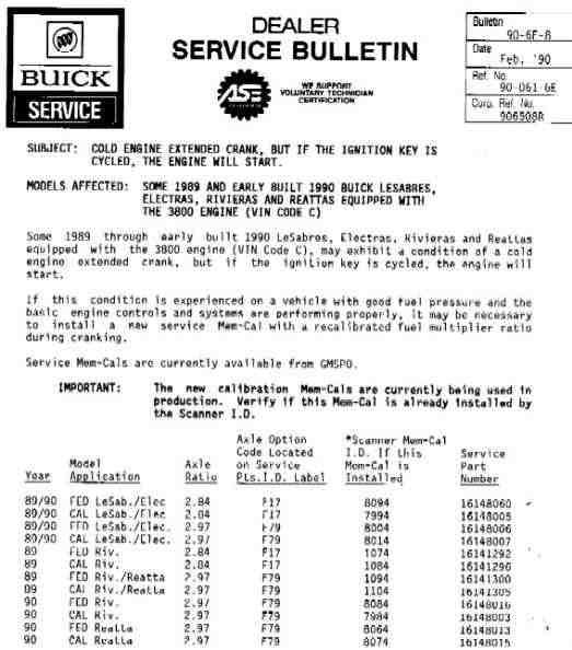

Padgett Posted August 20, 2022 Share Posted August 20, 2022 To get a second 2 second shot, turn to run (do not start) after 5 seconds turn off for a few seconds and turn on again. Wait three seconds and try to start. Was corrected by a different Prom. Have mentioned this before. Link to comment Share on other sites More sharing options...
Top Down Posted August 21, 2022 Topic Author Share Posted August 21, 2022 Thanks for the input. I tried sequencing the ignition key and unfortunately all that happened was a flooded engine which will not start. Any conclusions and/or alternatives? Link to comment Share on other sites More sharing options...

Top Down Posted August 26, 2022 Topic Author Share Posted August 26, 2022 Well, the verdict is now in.............bad fuel pump. Had the Buick Service Bulletin on cold starts checked against my car and found it to be not applicable as my car had the correct prom. So far the car starts 1st thing in the morning so the fuel pump must have been dying a slow death for the 6 or more months as it always started on the 2nd crank in the morning. Live and learn. Link to comment Share on other sites More sharing options...
