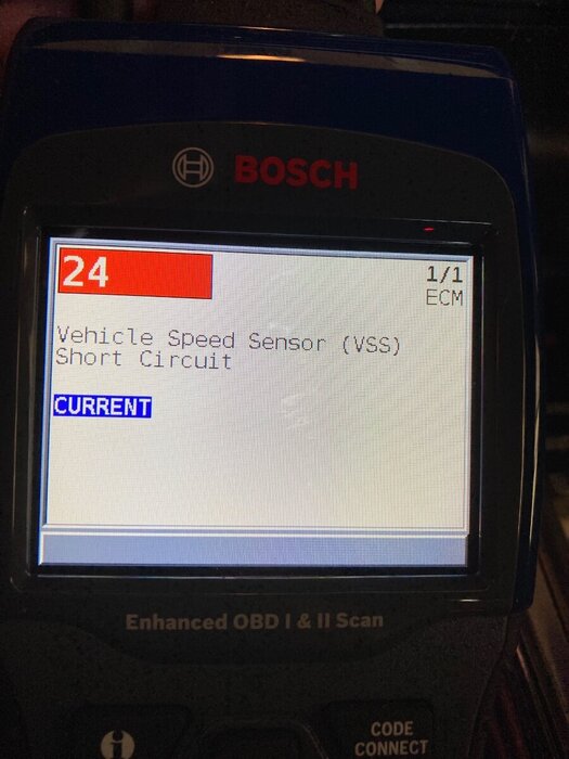

Osseobob Posted August 12, 2022 Share Posted August 12, 2022 OK so here is the puzzler. I was having a problem with my car hesitating around 55 mph. Did some research and found that the VSS or speed sensor will cause that. I purchase a scan tool to check the code and it turns out that the code is showing a bad VSS (speed sensor). Last saturday it kept stalling on my way home, after about 15 restarts and feathering the throttle I made it home. I purchase a new AC Delco VSS and install it. Take the car out for a drive and it runs absolutely great. Start the car later the same day and the code is back. I drive the car and its back to the same crap again. I try to clear the code and no matter what I try I cant clear it. I love my car but am about to drive it over a cliff. By the way it was relatively easy to replace. Just remove the right front wheel and its accessible from underneath. Any suggestions? 1 Link to comment Share on other sites More sharing options...

Osseobob Posted August 13, 2022 Topic Author Share Posted August 13, 2022 Its the code for the VSS. I pulled the Fuse and disconnected the battery and the code was cleared. took the car for a drive and it ran perfect. half way home the code came back on and it ran like crap again. I cleaned the connector with electric cleaner n no o better. The speedometer works perfect with no fluctuations. The motor runs out perfect if not driving the car. Link to comment Share on other sites More sharing options...

Osseobob Posted August 14, 2022 Topic Author Share Posted August 14, 2022 The car is a 1990 convertible. Scan tool is a Bosch. Link to comment Share on other sites More sharing options...

Osseobob Posted August 17, 2022 Topic Author Share Posted August 17, 2022 Update….. I unplugged the speed sensor. No trouble codes and car ran perfect for the first 5 miles. then the service engine comes on and the car started acting up again. tach was all over the place, engine started hesitation. seems like it’s only when the engine requires power. if I keep my foot off the gas or very light throttle no problem. If I give it throttle or kick it in the ass all goes bad. got back and reran scan tool and now have second code for cruise control. I’m guessing since it wasn’t showing any speed it triggered the cruise control code. figured out how to run the OB diagnostic and got a bunch of codes r033h, r034h, E042c, E024H, E042H, b124c, b552H, r026h, r061H. All advice appreciated! Bob Link to comment Share on other sites More sharing options...
Ronnie Posted August 17, 2022 Share Posted August 17, 2022 28 minutes ago, Osseobob said: ... tach was all over the place, engine started hesitation. seems like it’s only when the engine requires power. if I keep my foot off the gas or very light throttle no problem. If I give it throttle or kick it in the ass all goes bad. Classic symptoms of a bad ignition system. Could be the spark plug wires and/or spark plugs, ICM, or crank position sensor. Tach all over the place makes me think the crank sensor is going bad. Cruise control code can be expected with the VSS unplugged. I believe you have proved that a bad VSS isn't causing the engine problem. and I don't think the wiring going to it would. Reconnect the VSS and clear the codes in the diagnostics and see what comes back after driving again. Report them here. 1 Link to comment Share on other sites More sharing options...
2seater Posted August 17, 2022 Share Posted August 17, 2022 Now it is making a little more sense. The E042c is something wrong with the "C3" ignition circuit. The check engine light should be on and it likely goes into the limp home mode. The code chart is at the top of the forum page 1 Link to comment Share on other sites More sharing options...
