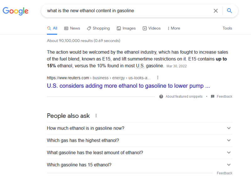

So I saw on Facebook today other people complaining about gas mileage decreasing in non Reatta vehicles. One reason provided is the higher content of ethanol in our gasoline now, which is something like 15% at present. Ethanol does not burn as efficiently as ethanol free. Could be another reason why your mileage is lower. Last year, I was consistently getting 27 mpg in my 88.
Edited by BlakesReatta
I'm not sure how much it varies from region to region. Common belief is that the Midwest is ethanol country because of corn production. Many stations sell E85 for use in Flex Fuel vehicles. I know that California has different blends of gasoline due to smog control, which is more expensive to produce.
