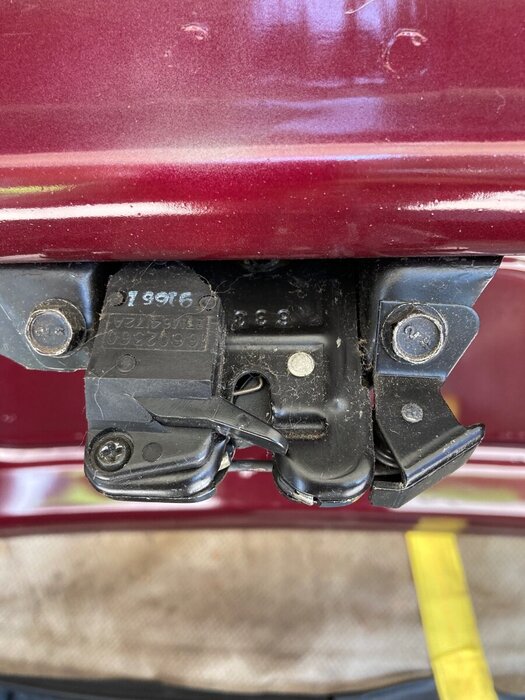

2seater Posted June 13, 2022 Share Posted June 13, 2022 On my '90, the switch is in the latch. The light will stay out as long as the lid is closed, even unlatched, but will pop on as soon as the latch starts to clear. I know this because I drive with the trunk lid unlatched the majority of the time and while driving with the rear pass through open, I noticed the light blinking on and off when traveling over rougher roads. I don't know if mine is odd, but it uses a two pronged single filament bulb, a 1004 from memory, not the 1003 called for in the FSM. It is not a self grounding socket, but a hot and ground are routed to the two contacts in the bulb. Link to comment Share on other sites More sharing options...

2seater Posted June 14, 2022 Share Posted June 14, 2022 Does the latch look like this? The lever extending from the small plastic switch on the left rear of the latch operates the light. What is the correct bulb? Link to comment Share on other sites More sharing options...

Ronnie Posted June 14, 2022 Share Posted June 14, 2022 My '88 trunk light works the way I expected. I don't see it but I assume there is a mercury switch somewhere in there. No switch in the latch like '90 (and probably '91) models. I removed my light from the trunk and clipped on a jumper for a ground. When I point the light fixture down, the light comes on. When I point it up, the light goes off. I can open my trunk about 6-8" without the light coming on. 1 Link to comment Share on other sites More sharing options...
2seater Posted June 15, 2022 Share Posted June 15, 2022 That looks the same as the under hood light. I wanted to reorient it for better coverage with an led, which is much more directional, but I couldn't due to the apparent switch in the socket. Now it makes perfect sense. 1 Link to comment Share on other sites More sharing options...
