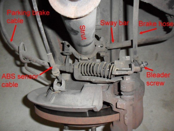

Ronnie Posted May 29, 2022 Share Posted May 29, 2022 Welcome the forum! What you need to do is jack the car up and remove the wheel so you can do a visual inspection to see where the fluid is coming from. Could be a seal in the caliper leaking or a bad rubber hose going to it. If it's the rubber hose leaking I wouldn't drive the car until its's replaced. The bleeder screw could be leaking but it's not likely unless someone has been working on the brakes. If you aren't familiar, this photo will show you what you will be looking at when you get the wheel off. Link to comment Share on other sites More sharing options...
frankg Posted May 29, 2022 Topic Author Share Posted May 29, 2022 Ronnie, thanks for the welcome and the information, including the photo with the parts identification on it. Very helpful. I got the wheel off and the hose is not leaking but it's probably 32 years old so I plan to replace both of the hoses going to the rear calipers and the short rubber hose that goes to the crossover line. What do you think of the ACDELCO service or rebuild kits for the calipers? I couldn't see any external leaking when I applied the brakes but got a seep coming out of the bottom of the caliper after I turned the engine off. Link to comment Share on other sites More sharing options...
