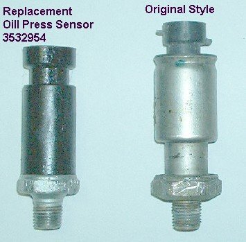

Padgett Posted May 26, 2022 Share Posted May 26, 2022 Was so common, Buick had a TSB. Original had silver body, replacement has black body & easy to snap. Link to comment Share on other sites More sharing options...

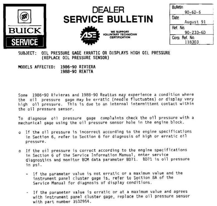

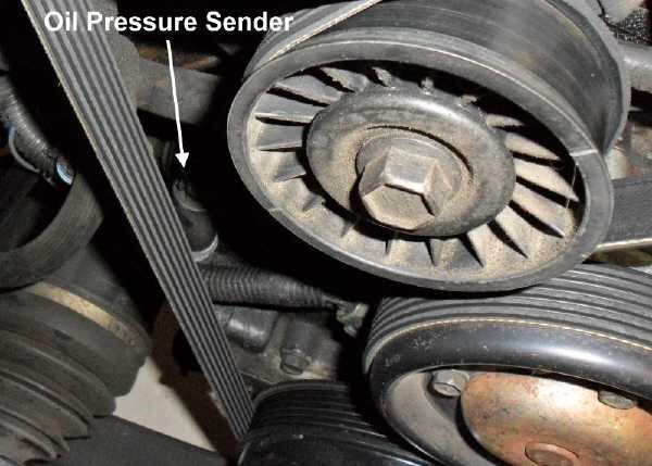

Padgett Posted May 27, 2022 Share Posted May 27, 2022 Like this ? Link to comment Share on other sites More sharing options...
