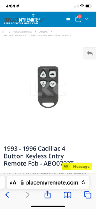

The one above is $69. I paid about $100 for my Cadillac fob from ECRP.
Actually think you want an ab00702t

The remote I listed is the ab00702t remote.
In the specs for that product it says FCC number: AB00702T
