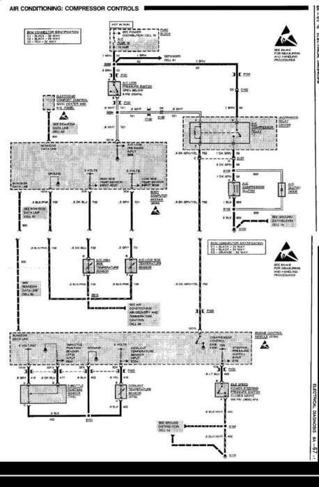

First thing everyone with a Reatta should acquire is a Factory Service Manual. That way I could just point you to the description in section 1B and the wiring in 8A-66-68. Just for teaching purposes as permitted by the DMCA, here is the AC compressor circuit.

I had forgotten about the relay. That is where I'd start. Check for power in the right places and just jumping the output should turn the compressor on.
