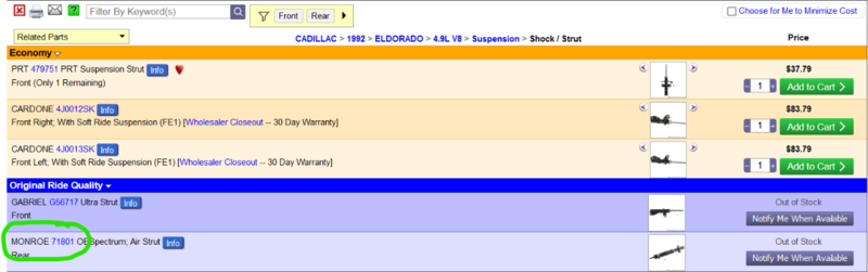

Eldorado Posted January 24 Share Posted January 24 Incredible detailed and good info here, all 33 pages, good team work! I am here because here seems to be the best hands-on knowledge of my problem: looking for struts for a 1992 Eldorado. That is probably even tougher than to find ones for a Reatta. I am giving up hope to find the OEM ones( as You know MONROE 71801), so what is the second best option? 71966 is said to be basically the same as 71801, but without the air ride height adjustment. The problem is, I understood that ride height will be to low without the air"lift". So need a slightly longer strut? - what do You guys think, would the DIY 801831 work in this application(slightly longer than the 71801), and using the bolt on sway bar adapter there might be some room for adjustment? - the 71831 is also getting hard to find...is the MONROE 801831 Monro-Matic Plus as good/usable? - last question to those of You whom removed the air bladder from a 71801: are the removed parts in usable condition or destroyed? Here a potential buyer..... I do understand this is little out of the Reatta scope but there is nowhere else to go! Thanks in advance for any comments, highly appreciated! 1 Link to comment Share on other sites More sharing options...

Eldorado Posted January 25 Share Posted January 25 (edited) 7 hours ago, Ronnie said: Not knowing anything about the '92 Eldorado suspension it would be hard to answer your questions. Does it use a single transverse leaf spring in the rear like the Reatta? Yes, it also use a single transverse leaf spring. Believe the suspensions are a very close design to each other, main difference is that the Eldorado is a bit heavier and uses the auto level/air bladder feature. Found on the net comments that they are identical, and quickly checking on online part diagrams it looks so, very much same parts, apart from the air bladders. Edited January 25 by Eldorado Link to comment Share on other sites More sharing options...

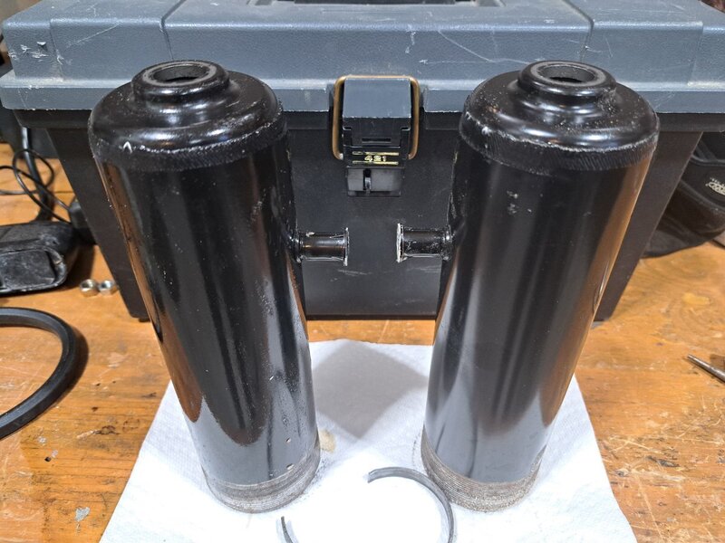

alchemist Posted January 26 Share Posted January 26 (edited) On 1/24/2024 at 2:53 PM, Eldorado said: - last question to those of You whom removed the air bladder from a 71801: are the removed parts in usable condition or destroyed? Here a potential buyer..... Just before 71966's became available again, I cut the air bladders off the set of new 71801's I had, effectively turning them into 71966's. That is an irreversible action, and now I wish I hadn't done that as I also purchased a set of the Monroe 71966 when they were available at Rock Auto. The bladder is held in place by two heavy crimped rings, one on the strut body and one on the upper cap. I still have all of the parts, save the bladders which had to be cut for removal. The crimp rings are also cut, but in my scrap metal bin with the upper caps. If you are interested in the caps and the rings, PM me. I might also let the base struts be purchased as I have a new set of 71966's on the shelf. Edited January 26 by alchemist Link to comment Share on other sites More sharing options...
Eldorado Posted January 26 Share Posted January 26 5 hours ago, alchemist said: Just before 71966's became available again, I cut the air bladders off the set of new 71801's I had, effectively turning them into 71966's. That is an irreversible action, and now I wish I hadn't done that as I also purchased a set of the Monroe 71966 when they were available at Rock Auto. The bladder is held in place by two heavy crimped rings, one on the strut body and one on the upper cap. I still have all of the parts, save the bladders which had to be cut for removal. The crimp rings are also cut, but in my scrap metal bin with the upper caps. If you are interested in the caps and the rings, PM me. I might also let the base struts be purchased as I have a new set of 71966's on the shelf. Thanks for the reply/comments to all of You! The parts might be useful! Will PM you little later. An important question is can i source a similar, or similar enough bladder from somewhere? The bladder You cut, is the shape a straight "pipe" or is the diameter different in various ends? In theory, if having the bladder caps and a 71966, with the help of a new bladder rubber, a 71801 can maybe be built? Attaching the bladder to the strut body might be a challenge without som special tools though. Have also been elaborating with the idea, can we modify a 71966 ( or a modified 71831 )to work somehow(on an Eldorado), even without the bladder? There always need to be som air in the bladder to have a proper ride height. How to achieve that without air? Option 1. What if we add a PU plastic shim/ring through the shaft, before we fasten the bladder cap to the shock shaft. Thus the caps would be on the same height( the shim would be between the cap and the shock body) as when inflated with a certain amount of air, but obviously not adjustable. Option 2. We add threads on the correct spot on the shock body, as also adding a corresponding nut. The lower end of the bladder cap will lean on the nut. In this case the ride height would be adjustable( somehow by turning the nut) in both examples, bottoming the shocks might be rougher than with the bladders...? Not sure this make any sense, pictures would be much better:) Link to comment Share on other sites More sharing options...

alchemist Posted January 26 Share Posted January 26 (edited) 2 hours ago, Eldorado said: Thanks for the reply/comments to all of You! The parts might be useful! Will PM you little later. An important question is can i source a similar, or similar enough bladder from somewhere? The bladder You cut, is the shape a straight "pipe" or is the diameter different in various ends? In theory, if having the bladder caps and a 71966, with the help of a new bladder rubber, a 71801 can maybe be built? Attaching the bladder to the strut body might be a challenge without som special tools though. Have also been elaborating with the idea, can we modify a 71966 ( or a modified 71831 )to work somehow(on an Eldorado), even without the bladder? There always need to be som air in the bladder to have a proper ride height. How to achieve that without air? Option 1. What if we add a PU plastic shim/ring through the shaft, before we fasten the bladder cap to the shock shaft. Thus the caps would be on the same height( the shim would be between the cap and the shock body) as when inflated with a certain amount of air, but obviously not adjustable. Option 2. We add threads on the correct spot on the shock body, as also adding a corresponding nut. The lower end of the bladder cap will lean on the nut. In this case the ride height would be adjustable( somehow by turning the nut) in both examples, bottoming the shocks might be rougher than with the bladders...? Not sure this make any sense, pictures would be much better:) Per Rock Auto, the 1992 Eldorado uses the 71801, which is the 71966 with the addition of the air spring, which consists of a sleeve, two crimp rings and one cap as shown in the picture. With the air spring components removed, the 71801 becomes a 71966 in every way, dimensions, stroke, threads, etc. so you could take a set of 71966 struts which are available through ECRP and bolt them right into your Eldorado. The only problem would be the lack of the air spring and self leveling. The bladder for the air spring was snug to the strut housing when I got them (see below), but with 50-100 PSI of air in them, they expand outward. Daves89 has an intact 71801 strut and you should take him up on the offer to purchase (if he ships from his northern warehouse I can arrange to get the caps in his hands). Monroe might be able to help you out with a piece of polymer for the bladder, but I would not hold your breath. Agreed, there would be some challenges with crimping new rings back onto the struts, but there are ways and that is a topic for the Eldorado forums (assuming they exist). Edited January 26 by alchemist Link to comment Share on other sites More sharing options...
