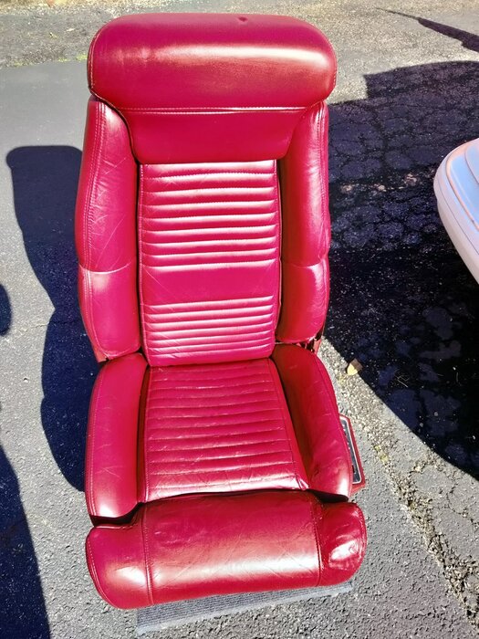

El-Grumpo Posted April 10, 2022 Share Posted April 10, 2022 My Reatta is mostly down to sorting out electrical and cosmetic concerns now, and I'm getting around to fixing up the seats. I've finished up the passenger seat and am working on the driver's seat now. I'm learning as I go, but I think the driver's seat will prove a challenge regardless. Used this video mostly for reference: 1 Link to comment Share on other sites More sharing options...
El-Grumpo Posted April 10, 2022 Topic Author Share Posted April 10, 2022 By the way if you ever have to move these further than your garage, get a cart or dolly! They are HEAVY Link to comment Share on other sites More sharing options...

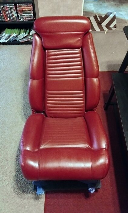

El-Grumpo Posted April 11, 2022 Topic Author Share Posted April 11, 2022 Thanks. It's definitely a learning experience and I made some mistakes, but it's still a big improvement (and I'm not trying to win awards haha.) I was surprised Duplicolor's burgundy vinyl/leather dye does a pretty good job of matching the color once fully treated (it probably helps I'm doing both seats so they'll eventually match regardless.) I just hope my work is sturdy enough, but time will tell! 2 Link to comment Share on other sites More sharing options...

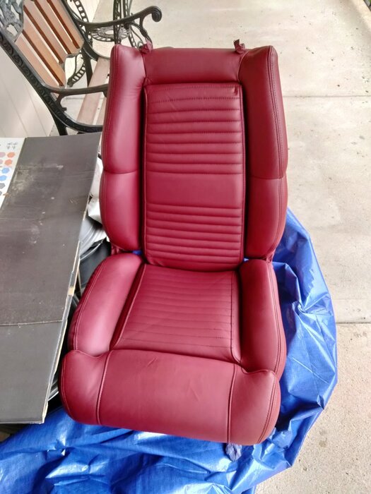

El-Grumpo Posted April 16, 2022 Topic Author Share Posted April 16, 2022 14 hours ago, Tallicat said: They look really good but not even close the the factory color. It's something I'm not terribly concerned with, since I'm doing both seats they'll match each other in the end. I'm fine if they're not 100% accurate or like-new, so long as I'm satisfied in the end. I've started working on the driver's seat, for those interested. I've removed the old patches and glue, then started applying patching underneath to secure loose ends and applying repair/filler and sanding where needed. 2 Link to comment Share on other sites More sharing options...

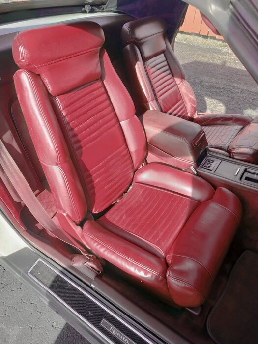

El-Grumpo Posted July 31 Topic Author Share Posted July 31 On 7/17/2024 at 11:05 AM, moosefuel said: How did the driver's seat turn out after all? Oh sorry this is a delayed response- I don't post very often! The driver seat turned out okay but sadly these repairs didn't hold up the greatest. The dye stuff did fine for the most part but the patch work didn't hold up- I'm guessing all the sun exposure caused some shrinking. I'm currently redoing the whole interior and have an alternative seat plan in the works, but it'll be a little bit more time before I can show any of that off. Link to comment Share on other sites More sharing options...
moosefuel Posted August 27 Share Posted August 27 On 7/31/2024 at 12:50 PM, El-Grumpo said: I'm guessing all the sun exposure caused some shrinking. Good to know! Man, that red looks bright in the sun! Link to comment Share on other sites More sharing options...
