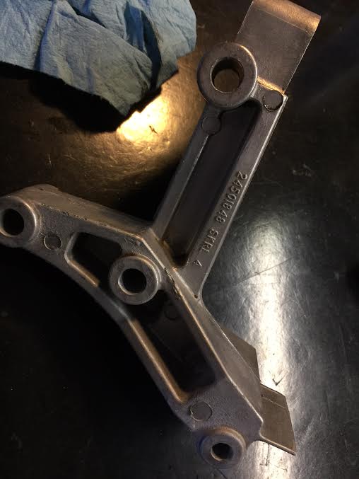

Frogware Posted February 3, 2017 Topic Author Share Posted February 3, 2017 Well I finally got the ICM switched out and she seems to be running fine now, but I won't know for sure until I drive it for a little longer. I did learn a few things from this whole ordeal; - First, there is a whole lot of grease caked on those brackets underneath. - Second, there are a lot of nuts on the bracket that hold quite a few ground wires. - Third, and very IMPORTANT the brackets are different!!! (See the Pics below) My donor car was a 1994 LeSabre that had a blown engine from a water pump failure (there were several bearings on top of the water pump pulley). It took me a while removing the bracket because I wasn't prepared for how many nuts there were on the bolts. I took the top two off and wiggled the ICM and thought what then I noticed another nut so I repeated this three times, but oh well. After all the bolts and nuts were off I noticed that it was also bolted to the alternator, so I removed that bolt and finally it came loose. I took my heavily grease caked ICM home and proceeded to soak it in degreaser, after which I took it to the car wash and tried to spray it off...No Luck!!! That stuff was not budging. So then I proceeded to take a wire brush to that stuff with some more degreaser and it finally came clean. Link to comment Share on other sites More sharing options...
kdirk Posted February 3, 2017 Share Posted February 3, 2017 Well done. I'm not familiar with changes to the NA 3800 after 1992, so maybe the 94 is different and requires more disassembly, but I've never had to remove the alternator bracket, just the mounting plate with the three square head bolts. Access to the locknuts underneath is tricky, but doable. Point being you may have done a bit more tear down than really needed but you got the job done. Of course, changes in the setup on a 94 may have necessitated the approach you took. Kevin Link to comment Share on other sites More sharing options...
Frogware Posted February 3, 2017 Topic Author Share Posted February 3, 2017 Yeah the three bolts on the plate, two were accessible but the third was shrouded by those grounding wires and a very tight squeeze between the radiator. So I had to remove all that stuff, but like you said I got it done. Thanks! Link to comment Share on other sites More sharing options...
