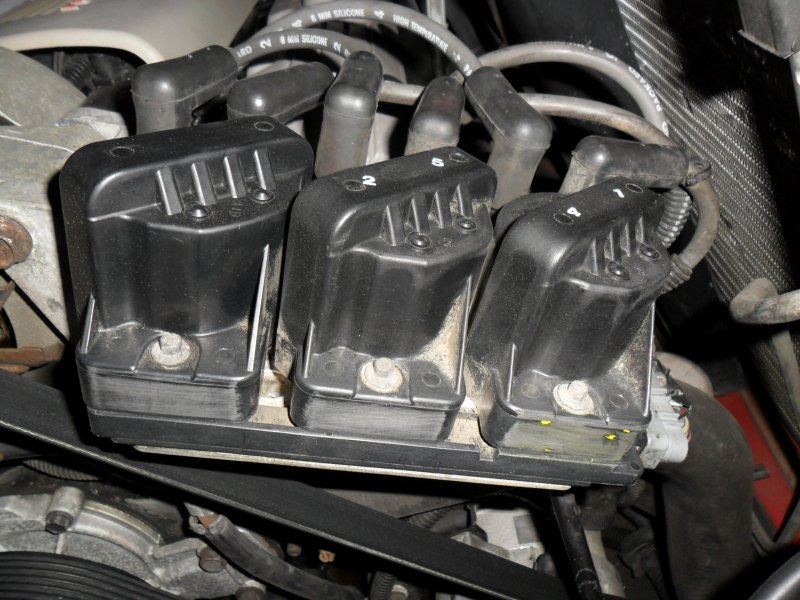

Ronnie Posted January 24, 2017 Share Posted January 24, 2017 Thanks everyone! So is there an ICM preference on which one or year to get, I've read some posts where they put a 95 year one in and it seemed to work better, what do you think? This page will tell you everything you need to know. Look for a Delco ICM on anything after 1992 with a 3800 engine that has the same connector as shown in the photo below. I printed the photo of the connector and took it to the junk yard for reference when I went to get my Delco ICM. You need to get the complete module with three individual coils mounted on top as shown below. Link to comment Share on other sites More sharing options...

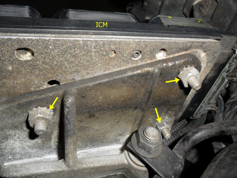

Ronnie Posted January 25, 2017 Share Posted January 25, 2017 Here is what I remember doing when I went to the salvage yard to get my Delco ignition for my '88. It has been a while so maybe someone will have something to add. Remove the ICM electrical connector. I think it takes a 7mm wrench. Remove the spark plug wires.The coils should be numbered but take note of how the wires go. Remove the three nuts on the bottom of the mounting bracket shown in the photo below. Get the whole thing as a unit. No need to remove any of the small screws that hold the coils to the ICM. Clean the mounting plate on your car. Mount the Delco unit to your mounting plate and connect the wires. Some people only use the two nuts that are easy to get to. Be careful not to mix up the spark plug wires. It is easy to do. You will have to route the wires a little different for the Delco ICM. Link to comment Share on other sites More sharing options...
