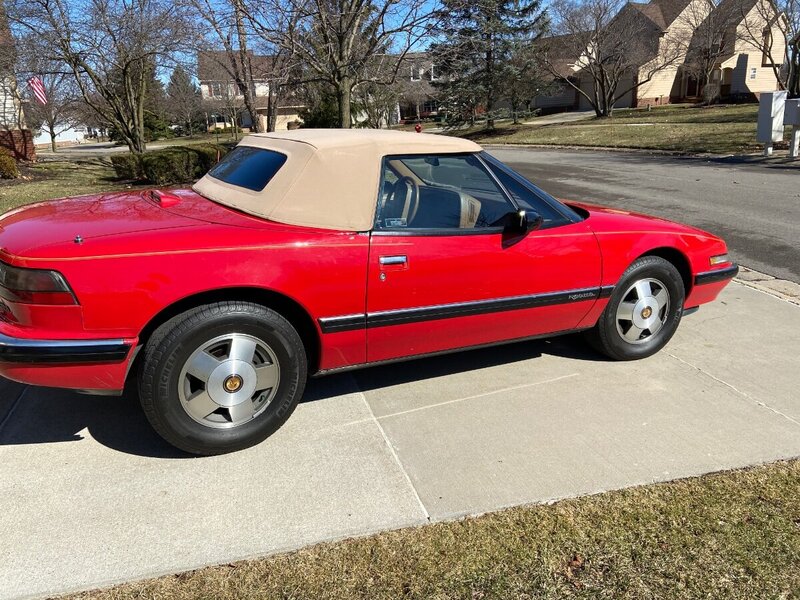

Karl Posted March 23, 2022 Share Posted March 23, 2022 The oil pressure gauge readings are bouncing all over the place on my 1990 convertible. Engine is running fine and I know the sending unit is typically the problem. Remember reading that there are several sending units that will supposedly work on our cars, but they don’t all work. I can’t find that info and I’m looking for part number or specific sending units to order. thanks, karl PS just had to add a picture with the new cloth top that I just had installed 😁😁 Link to comment Share on other sites More sharing options...
