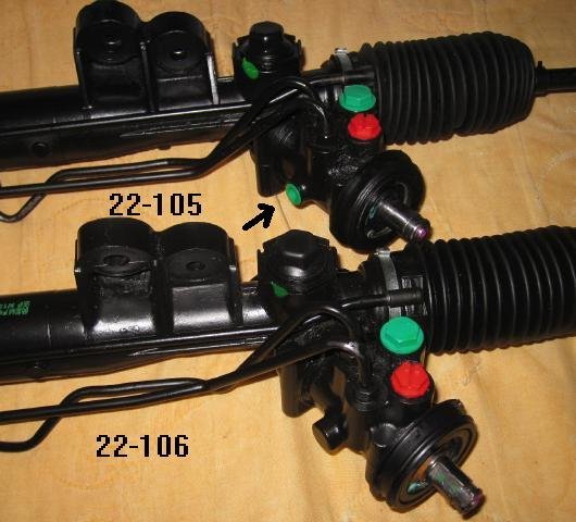

DAVES89 Posted February 17, 2022 Share Posted February 17, 2022 The Reatta calls for three connections to the rack. You need all three. The catalogue offers two port as well and that wouldn't work. Link to comment Share on other sites More sharing options...
Ronnie Posted February 17, 2022 Share Posted February 17, 2022 Dave is right. In the photo below a black arrow is pointing at the third port where the steering rack pressure switch screws in. The other rack on the bottom looks similar but the port where the pressure switch screws in is not drilled and tapped for the switch. Thanks to whoever supplied the photos. Link to comment Share on other sites More sharing options...
