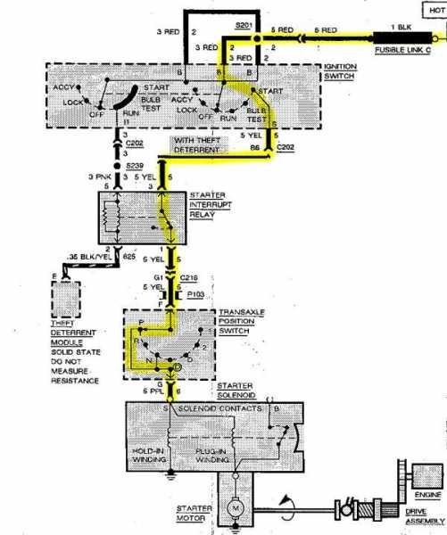

Ronnie Posted January 24, 2022 Share Posted January 24, 2022 I think you will have to go through the yellow highlighted circuit below step by step to find why power isn't getting to the starter. I would start by checking the yellow wire going into the transaxle position switch to see if has power when the key is turned to the start position. If is does not the problem is with the ignition switch or the starter interrupt relay not being picked up. Link to comment Share on other sites More sharing options...
Ronnie Posted January 24, 2022 Share Posted January 24, 2022 BTW, Don't worry about the dash lights and interior lights going out as being part of the problem. That is normal on my car when the key is turned to start... even if the gear selector isn't in Park or Neutral. Link to comment Share on other sites More sharing options...
