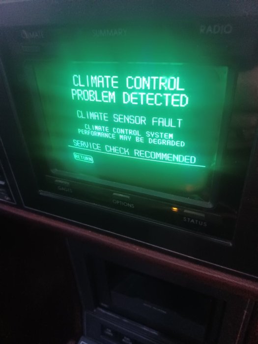

@Ronnie below is picture of what I was talking to you about, I went into status then clicked on Diagnostics, then even the climate control said ok I pressed the button and this popped up.

Ignition module is more likely to fail than the coil pack on a Magnavox. Was the ICM replaced as well as the coils? Did you check for vacuum at the black line connected to the center of the bunch of vacuum tubing on the bottom of the HVAC Programmer, (engine running)? It is the main feed to the controller and the other end is at the tee shown in Ronnie's photograph.
To test the air diverter door for the HVAC system, you must change the temperature on the climate control, up and down, and observe the rod from the controller through the glove box opening. It does not move rapidly but it should move visibly when the temperature is adjusted. If it doesn't, that may be part of the communication issue.
