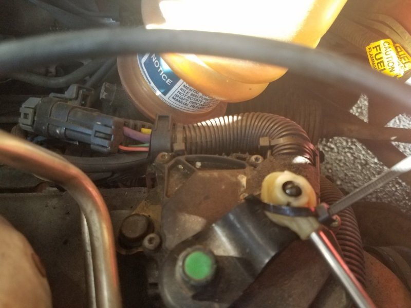

RemSteele Posted November 16, 2021 Topic Author Share Posted November 16, 2021 Please confirm if this is the linkage. Would this be the cable lubricated? Link to comment Share on other sites More sharing options...
Padgett Posted November 16, 2021 Share Posted November 16, 2021 Yes, with the zip-tie fix. at the end of the rod is a cable. Link to comment Share on other sites More sharing options...
