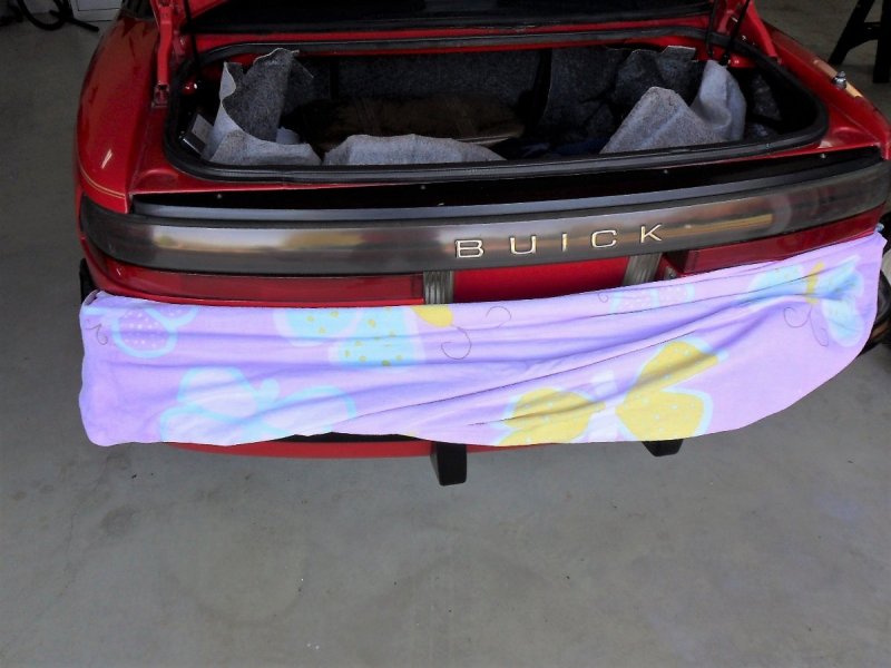

Ronnie Posted October 8, 2021 Share Posted October 8, 2021 I think Dave89 has a better way to do it than I used. My tail light was dirty inside because of a small leak and didn't look too good. Instead of taking it apart and taking a chance of breaking it, I decide to try VHT Nite Shades to tint it to hide the imperfections. I think it turned out really well although I did get it a little darker than I intended. Still I'm very happy with the results. Below is a before and after photos of how it looks. Before: After: 1 Link to comment Share on other sites More sharing options...

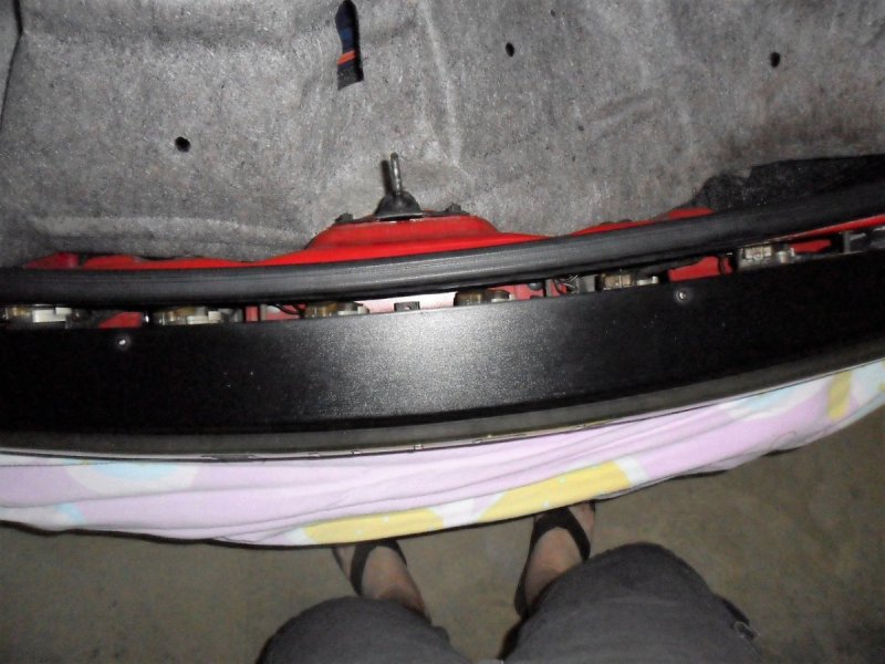

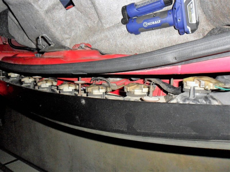

Ronnie Posted October 8, 2021 Share Posted October 8, 2021 If you remove the taillight assembly don't forget to remove the license plate first. If you leave it on you are almost certain to break the red reflectors on the bottom of the taillight. Also, after removing the thumbscrew nuts inside the trunk that hold it on pull straight back to prevent breaking the studs as you remove it. Go back in with the assembly the same way and don't over-tighten the nuts. Everytihng is brittle and will break easy. Below are some photos that you might find helpful. 1 Link to comment Share on other sites More sharing options...
