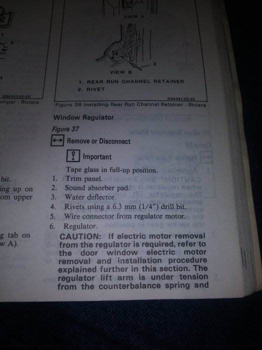

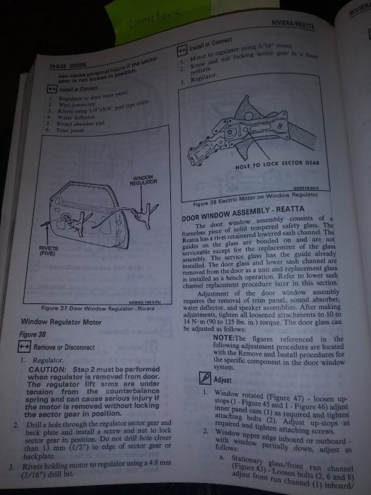

Philbo Posted September 30, 2021 Share Posted September 30, 2021 Here is the instruction on removing the window regulator from my 1990 manual just to give you an idea. I have had the trim off to replace the door handle on mine and it isn't too bad of a job. Link to comment Share on other sites More sharing options...
Padgett Posted September 30, 2021 Share Posted September 30, 2021 Not too hard, always replaced the rivets with screws. Feel Siemens are better than ACDelco. Link to comment Share on other sites More sharing options...

Padgett Posted October 1, 2021 Share Posted October 1, 2021 Be vary careful of the spring, it can be dangerous. Link to comment Share on other sites More sharing options...
DAVES89 Posted October 1, 2021 Share Posted October 1, 2021 My mechanic buddy, Kendall did my window motor. He had 5 vice grips on it to hold it. he also had an air powered rivet gun. Drove all the rivets in about 5 minutes. Link to comment Share on other sites More sharing options...
Philbo Posted October 2, 2021 Share Posted October 2, 2021 The manual says to drill a hole and secure the gear (and spring) with a nut and bolt. I thought that was interesting. Not sure I would trust vice grips. I feel like there would bee too much risk that they slip. Link to comment Share on other sites More sharing options...
Padgett Posted October 2, 2021 Share Posted October 2, 2021 Best to take the manual's advice, that spring is strong. Link to comment Share on other sites More sharing options...
