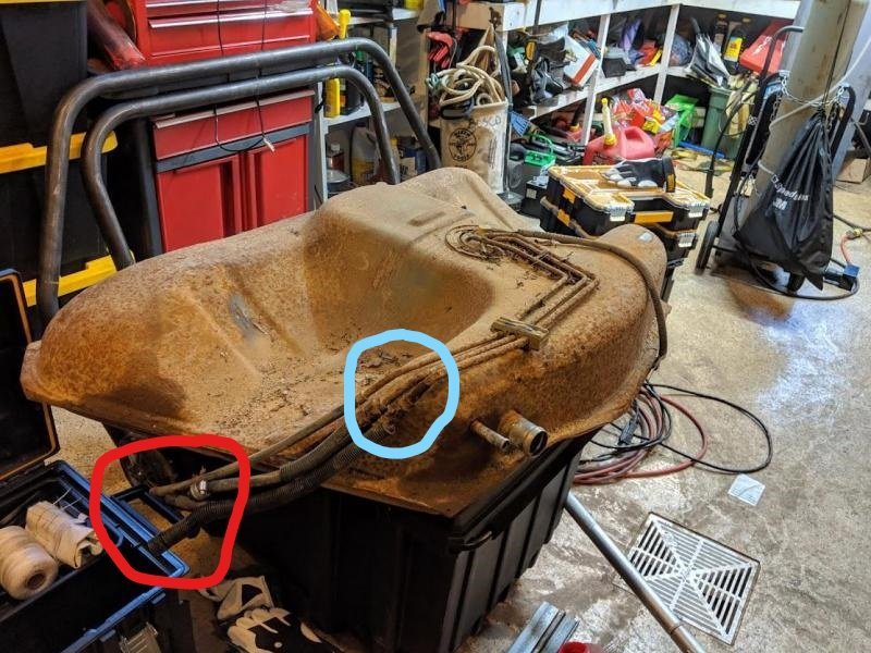

Ronnie Posted August 31, 2021 Topic Author Share Posted August 31, 2021 Found this photo of what I believe is a Reatta fuel tank. Are the lines normally disconnected in the area circled in blue, or red? I'm thinking the answer is blue. If blue I assume the tank will need to be dropped down part way to get to those connections? Link to comment Share on other sites More sharing options...
2seater Posted September 1, 2021 Share Posted September 1, 2021 The blue area is where the hard lines from the tank connect. There is some room to access but it is why I cautioned to be sure the fitting was held firmly when disconnecting. It is sort of by feel. Link to comment Share on other sites More sharing options...
Ronnie Posted September 1, 2021 Topic Author Share Posted September 1, 2021 7 minutes ago, 2seater said: There is some room to access but it is why I cautioned to be sure the fitting was held firmly when disconnecting. It is sort of by feel. Do you recommend dropping the tank down some first or try to disconnect the lines first? Link to comment Share on other sites More sharing options...
2seater Posted September 1, 2021 Share Posted September 1, 2021 6 hours ago, Ronnie said: Do you recommend dropping the tank down some first or try to disconnect the lines first? Any additional room is beneficial. The lines to the front of the car have a flexible section which are permanently crimped to the hard lines. Only you can judge if it will be necessary. I looked through my photos from last year and can't find anything specifically relevant🤨 Link to comment Share on other sites More sharing options...
Ronnie Posted September 1, 2021 Topic Author Share Posted September 1, 2021 Thanks for all the help and suggestions so far. I've decided to get my friend Donnie Turpin to do it for me at his garage if he has time but I'm making plans on the best way to do it myself if he can't get to it. 1 Link to comment Share on other sites More sharing options...
Ronnie Posted September 2, 2021 Topic Author Share Posted September 2, 2021 I spent some time under my Reatta looking at the gas tank today. Looks like dropping the sway bar will be easy. The filler tube and vent hose clamps were turned for easy access so don't see a problem there. If I'm looking at it right the fuel lines appear to be out in the open and just held to the inside of the frame rail with a clamp as shown in. If so that would make the connections be in the area circled in red in the photo above. Is that right or am I looking at it wrong? I should have taken a photo while I was under there... With the rear as high as my jack stands would go all I could do is get my head and shoulders under the area where I would be working on getting the tank out. As big as I am I'll need both ends up as high as I can get them for me to do it. Hard part will be jacking it up all the way around and getting up and down to get wrenches a few dozen times. Bad knee that will need replaced eventually didn't like me getting up and down a half dozen times today. Brain is saying do it. Body is saying no. 🙂 Link to comment Share on other sites More sharing options...
2seater Posted September 2, 2021 Share Posted September 2, 2021 I am not 100% sure on this now but I think what you are referring to may be the end of the flex lines where the attach to the hard line going forward? I don’t remember them being separable and even though the red car is here, I had to modify a bunch due to rust. The clearance underneath is why I suggested ramps for the very heavy front end and jack stands at the rear. Seems more stable for doing a little tugging. Also why I don’t use a creeper, just an old carpet remnant. A tray for expected tools will be a plus, also for the removed fasteners. Old baking pan😉 Link to comment Share on other sites More sharing options...

Ronnie Posted September 2, 2021 Topic Author Share Posted September 2, 2021 I decided to slide back under the car today and take some photos. The first photo shows the fuel line connections looking toward the back wheel. The other photo shows the connections straight on from under the car. They are right in your face and easy to get at if I'm looking at the right connections. Is my '88 model fuel line connections different from other years that are harder to get at? Link to comment Share on other sites More sharing options...
Padgett Posted September 2, 2021 Share Posted September 2, 2021 Dunno, just did on my '88 before had a lift so did on large jackstands. AFAIR I just let the sway bar swing down but was a decade or so ago. 1 Link to comment Share on other sites More sharing options...
2seater Posted September 2, 2021 Share Posted September 2, 2021 That looks good Ronnie. You are indeed correct about the connections; in the red area they can be disconnected. In my defense, the red 89 had already been repaired several times before I got it and the donor can lines were just repaired without accessing the tank area on the donor car. My 90 is completely different. Should be a piece of cake on a rust free car. 1 Link to comment Share on other sites More sharing options...

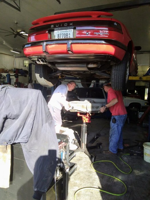

Ronnie Posted October 18, 2021 Topic Author Share Posted October 18, 2021 Got the fuel pump replaced this morning. I got there a little before 9:00 and Donnie and his 3 workers showed up about the same time. We had to eat Hardee's biscuit & gravy he brought before he went to work. He got it on the lift about 25 after 9:00. He wouldn't let me help. He said his insurance had been on him about not letting anyone in the work area so he got one of his crew to help him. I just stood at the door and talked to him while he worked. At 10:36a he was letting the lift down. That is what I call QUICK! It would have took me at least 2 days laying on my back to do it. He turned the key three times and it started after a few turns. After that it started as it should so he pulled it outside. He put his pressure tester on it and it idled at 36 psi which I thought was a little low but he said that wasn't too unusual with a regulator that old. When you hit the throttle and vacuum drops pressure jumps UP to about 41 psi. Before replacing the pump it would drop to about 27. He said he wouldn't replace the regulator as long as it is working as good as it is. He said he doubts I would be able to tell the difference in the way the engine would run if I replaced it. What do you guys think? Would you replace the regulator? Driving home I could tell it ran as it should and accelerates much much better. When I got home I put my tester on it and hooked up the jumper to the prime connector. It will hold a steady 47 psi without the engine running so the pump is capable of putting out plenty of pressure. I feel safe about driving now without fear of being stranded on the side of the road. Link to comment Share on other sites More sharing options...
