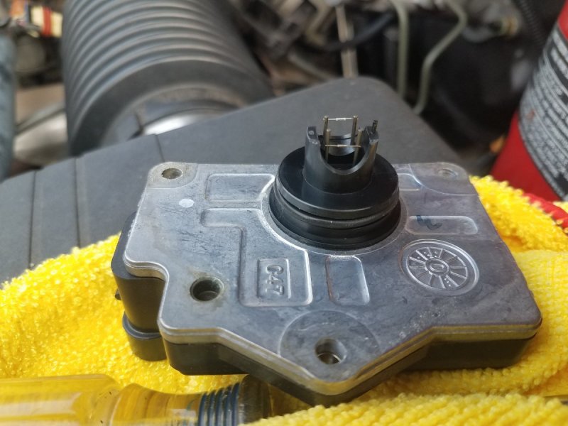

RemSteele Posted July 21, 2021 Topic Author Share Posted July 21, 2021 Broken MAF sensor. New one on order for this afternoon $$$ I'll keep you posted. Thanks, RJ 1 Link to comment Share on other sites More sharing options...
RemSteele Posted July 21, 2021 Topic Author Share Posted July 21, 2021 Link to comment Share on other sites More sharing options...
RemSteele Posted July 22, 2021 Topic Author Share Posted July 22, 2021 Update: New one installed. Cold start this morning, everything appears to be corrected (concerned as my mechanic said keep the box-they can be finicky) At almost $200 bucks I expect them to work right the first time. Take away: Sample clearly broken- should have the elements enclosed in a plastic covering with a opening : Get a spear if you can : They make a refurbish one around $100 and a core is required : The car will run with it broken just line up the piece so the air flow isn't restricted (or remove) : Jury is still out on the CRC clean spray/cleaner I hopes this helps someone as I have been able to get a lot of help from this site. Thanks Ronnie as always for pointing me in right direction. See you guys when I get back from the PVGP, Regards, RJ 1 Link to comment Share on other sites More sharing options...
Ronnie Posted July 22, 2021 Share Posted July 22, 2021 3 hours ago, RemSteele said: should have the elements enclosed in a plastic covering with a opening Probably wouldn't work correctly. The elements must be in the air stream in order for them to be cooled by the air passing over them which changes the resistance giving the ECM information about how much air is passing through the intake. The ECM uses that information as part of it's calculations to determine the correct amount of fuel to inject into the cylinders. 1 Link to comment Share on other sites More sharing options...
2seater Posted July 22, 2021 Share Posted July 22, 2021 (edited) The later model MAF for a 91 looks identical externally but it is configured as described. Performance is the same but the elements are better protected when removed from the housing. Cannot be retrofitted. Glad you found the problem. Many of us have spares culled from the salvage yards for just such an event😖 Edited July 22, 2021 by 2seater 1 Link to comment Share on other sites More sharing options...
