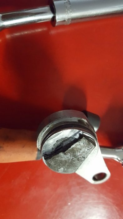

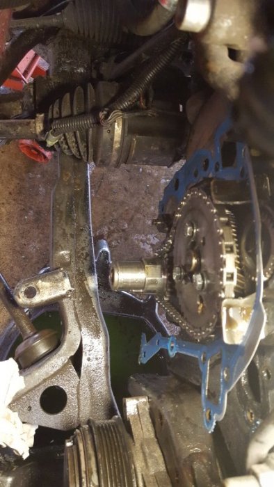

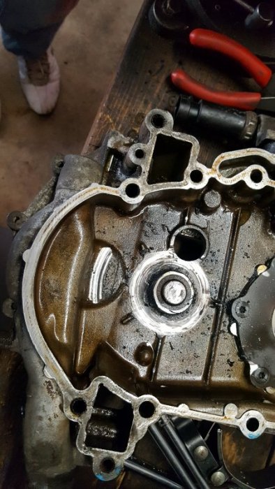

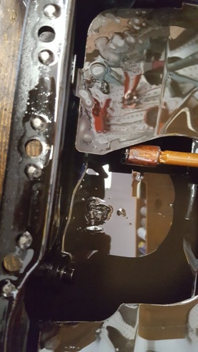

Ronnie Posted June 27, 2017 Share Posted June 27, 2017 Below are photos of the damage from the loose cam bolts that Dave sent me. There's just no excuse for leaving those bolts loose. Link to comment Share on other sites More sharing options...
DAVES89 Posted June 28, 2017 Topic Author Share Posted June 28, 2017 I stopped by the engine builder with my bill for the labor and parts. He was much more interested today and took time to talk to me. He did changed his attitude from "I know I tightened those bolts" to "I was sure I tightened those bolts". So he was better about it. I told him how close we were to having a ruined engine and what the side cover looked like and what Kendall did to "clean up" the engine prior to putting everything back together. I really think that the cam sensor was what kept the cam sprocket bolts from coming all the way out and ruining the engine. I also said that Kendall did check the bolts on the crank and they were good. I also said that I have about 2500 miles on the engine and everything else seems fine. He agreed that changing the oil again at 5oo miles was a good idea. He also was glad to hear what Kendall did to clean the oil pickup [from both ends] and cleaning the side cover and rinsing down the side of the engine to get rid of as much shavings as possible. Kendall, the engine builder, and I agree that with the miles I have been driving that if anything got into the bearings we would know it by now. I have put on about 125 miles since Monday and so far so good. The engine starts, runs, has good acceleration, and doesn't smoke so I should be good. Link to comment Share on other sites More sharing options...
