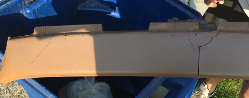

DAVES89 Posted June 12, 2017 Topic Author Share Posted June 12, 2017 Hey Guys, Thought you would like to see how badly my old dash broke down. I did remove the pod that holds the IPC and Headlight/Wiper pods, but looks pretty bad. A lot of Florida summer and heat. Link to comment Share on other sites More sharing options...
Ronnie Posted June 12, 2017 Share Posted June 12, 2017 I didn't notice it being broke that bad when you were here. All I remember was a little cracking at the defrost grill. Did pulling the dash out make it worse or did it get worse slowly over time? That photo reminds me why I don't want to change my photocell. My dash is nice other than being slightly warped on the passenger side. I guess heat did that. I think it was that way when I bought the car. Link to comment Share on other sites More sharing options...
DAVES89 Posted June 12, 2017 Topic Author Share Posted June 12, 2017 The diagonal crack on the left was from removing the pod and throwing it in the garbage, but the rest were there from before. That straight crack from the hlf round crack showed up sometime last summer. It was time to replace it. Link to comment Share on other sites More sharing options...
