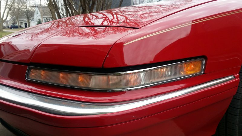

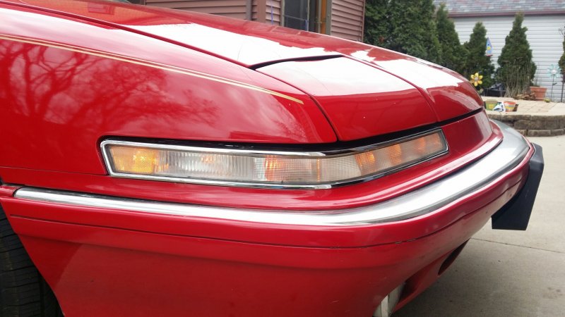

DAVES89 Posted March 21, 2017 Topic Author Share Posted March 21, 2017 I fired up the Red this morning to see what the "new" cornering lamps and foglights look like. The cornering lamps and fog lights are as nice as the ones on the 'vert. I cannot believe I found some as nice as these. They may not be NOS but they are very very nice. Bought them for $15.00 each and the fog lights were $5.00 each. The fog lights have LEDs in them as do the head lights so they make a good match. The cornering lamps are original style bulbs. After the engine is in I am taking the car over to Ryan [the body man friend] for touch up painting. I also dropped off the intake today for him to paint. 2Seater can verify this in regards to the 5000 mile motor. When I took the air intake and thermostat intake pipe off the car we couldn't believe how fresh the gaskets look. I think if I wanted I could use the gaskets over as the nuts/bolts came off easily and the gaskets "let go" without any damage to them. I wish that motor would have been good. I know I am spending some cash on this car, but I really only have this car as a "hobby" and have never gotten into golfing, hunting, or fishing so never had that expense. I am sure that this will be my last "go around" so I am doing it with no regrets. Link to comment Share on other sites More sharing options...

DAVES89 Posted April 2, 2017 Topic Author Share Posted April 2, 2017 Here's some pictures of my new cornering lights. They are even clearer then what the pictures show. Link to comment Share on other sites More sharing options...
