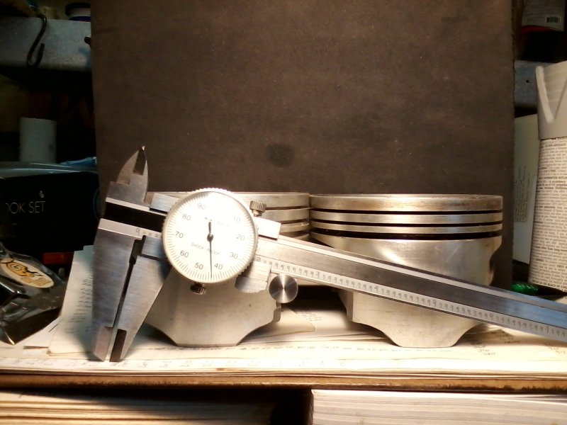

2seater Posted January 26, 2017 Share Posted January 26, 2017 New suggested piston on the left vs original and height difference mounted on a common pin between the two. Link to comment Share on other sites More sharing options...
Ronnie Posted January 26, 2017 Share Posted January 26, 2017 That looks like quite a difference. I guess it is about .045" like the calipers show? More compression and a hotter '88 cam should make a difference. Link to comment Share on other sites More sharing options...
2seater Posted January 27, 2017 Share Posted January 27, 2017 Sorry about the quality of the photo. I didn't realize I had that glare on the dial. It is .044" actually. It winds up about zero deck to the block. The reason I posted it here is I couldn't attach it to the PM to Dave without doing the URL thing. I do think about a half point more squeeze and a little more cam should give a friendly shove. Link to comment Share on other sites More sharing options...

2seater Posted January 27, 2017 Share Posted January 27, 2017 I do not know how much could be milled from the head as I have never done so, but my theory is to leave as much metal as possible unless it is required to get the head flat. My experience has been that the Buick 3800 head is nice and flat on a good running engine and requires no additional machining. Only checking with a straight edge will tell. The 3800 has a small chamber to start with, about 38cc's, with a 10* valve angle so they are quite shallow. I wouldn't encourage any additional reduction in head volume. The later engines, such as the Series 2 has an improved heart shaped chamber shape that tolerates 9.5 :1 compression ratio, or better, on 87 octane. Link to comment Share on other sites More sharing options...
Ronnie Posted January 27, 2017 Share Posted January 27, 2017 If you get the compression too high on 87 octane fuel the engine might ping causing the knock sensor to tell the ECM to retard the timing. When that happens your extra horsepower will be lost. You might get a little extra power out of opening up the exhaust manifold if it has an obstruction like in the photo below. Link to comment Share on other sites More sharing options...
