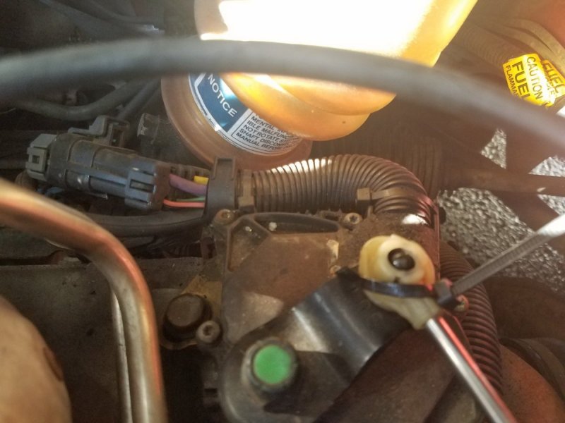

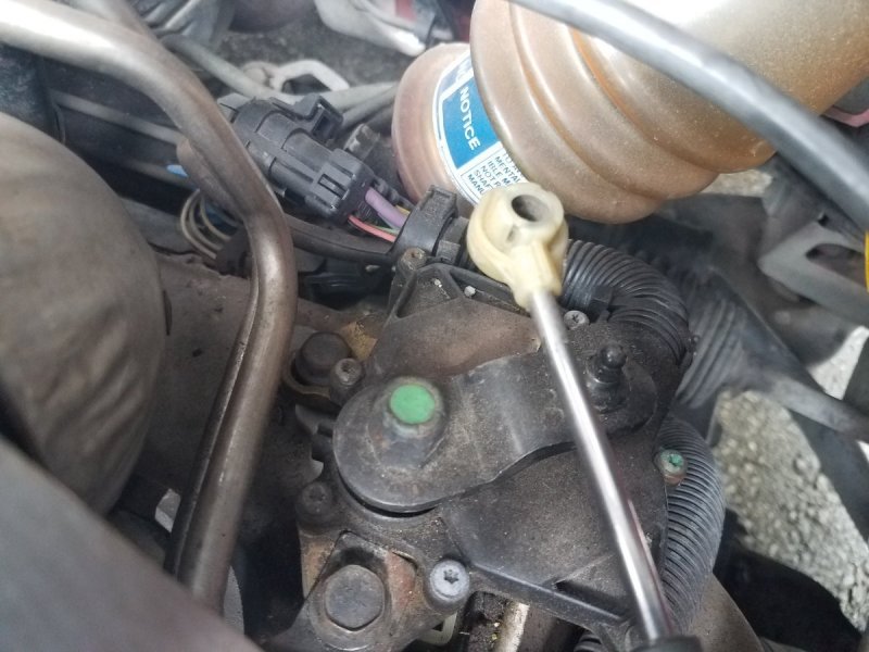

Need your help. Had a scare this morning. No gears, not even park. After cooler heads prevailed I was able to take a look and I see my shift cable popped off.
Of course it appears not to just pop back on and stay.
Am I replacing the entire cable? A quick google search shows a bushing repair kit?

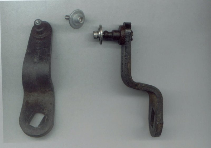

It's a fairly common problem. Some people just tie it back on with bailing wire or something. Others have took the time to drill and tap the lever so a screw can be used to hold it on as shown below

Machiner55 [over there] did a repair on March 9 2013 using a drill and tap followed by a set screw and washers

It might work great but I would be concerned about the drill bit hanging and breaking the brittle plastic end off the cable rendering the cable useless. I'm a machinist and I can see that happening. It looks like it is an expensive alternative to a piece of wire tied around the arm to hold the cable in place. A piece of stainless wire would probably outlast most of our Reattas.
